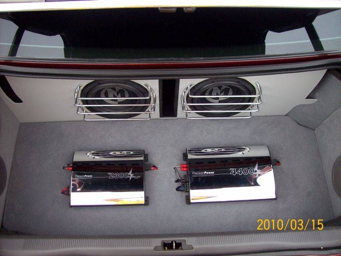

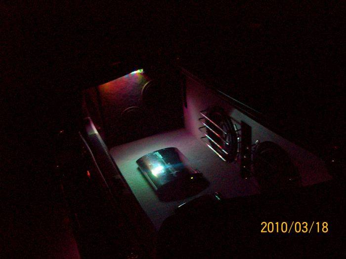

My set-up is very easy.

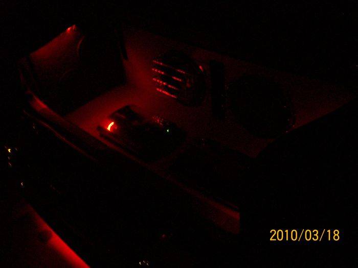

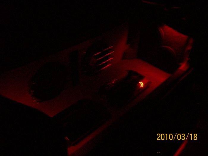

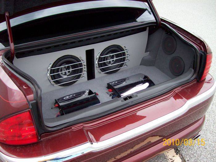

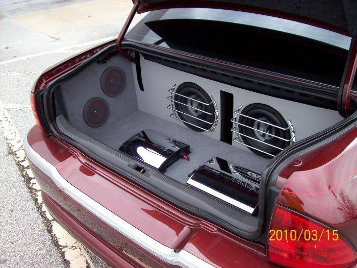

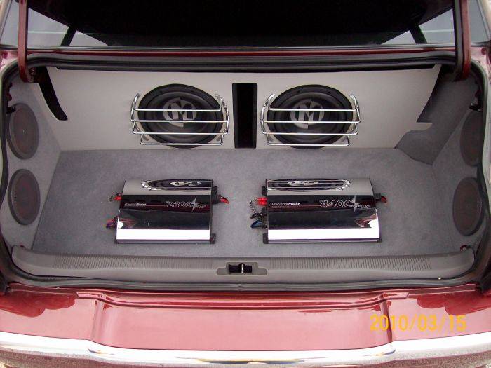

I removed the factory floor mat piece. Slid my sub box into place. Made a simple bueaty board for the front of the sub box. Use a piece of cardboard as a template. Cut it to the shape I needed. Traced it on to a piece of 1/2" plywood. I had to test fit it a few times to get it to fit just right. Wrapped it in color matching carpet. Done. Did the same with the side pieces. Took me about 30 minutes. Everything is tight. No mounting screws or anything. I can have it all out in a few seconds.
Pictures of the "new" look.
