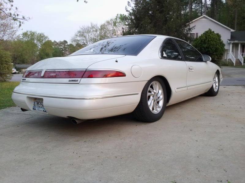

Quit worrying lol, like ford nut said, it's common.I can go crank mine right now and my mufflers will also leak a little water Let me show you something. The first pic is of my car after it had been ran for maybe 20 seconds.

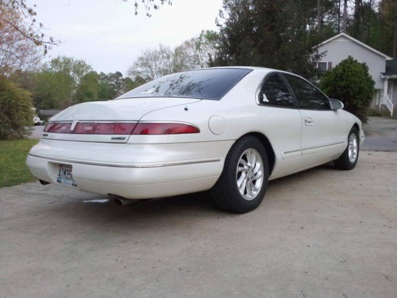

Next pic is after it has ran for about 5 minutes. Look on the concrete under my drivers side muffler.
This is perfectly normal.

See this? Normal! Mine does this, my 94 done it and the 93 done it. All with stock mufflers. I chopped the mufflers on the 94and this stopped. Our mufflers hold more moisture than they should and this is why they are rusted up next to the front of them.
