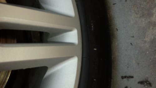

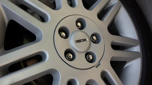

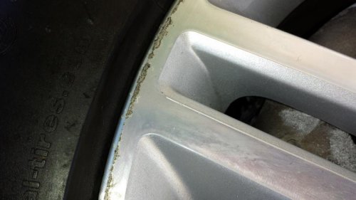

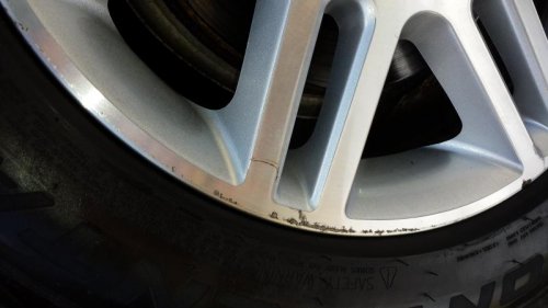

Saw Fonzie's video on the true metallic dip used to refinish wheels to a stock oem look. I ordered a can of aluminium and the glossifier to experiment. This is my first time dipping a wheel so this was just a learning experience for me. Two of my wheels are in bad shape, the PO probably scrapped a curb really bad. 20130614_130812.jpg20130614_130803.jpg20130614_130809.jpg

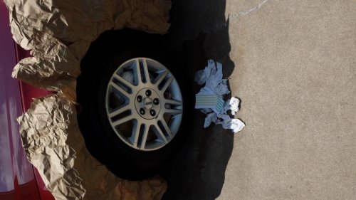

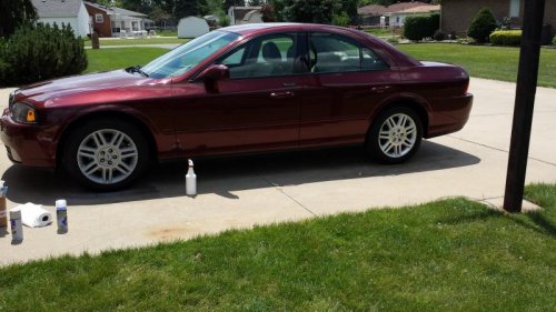

Anyway, used the dipping spray to clean the wheel. Used paper towel instead of painters tape because I accidently bought blue duct tape at the store:Bang 20130614_132226.jpg

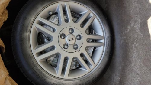

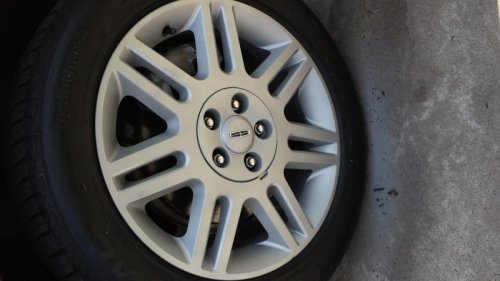

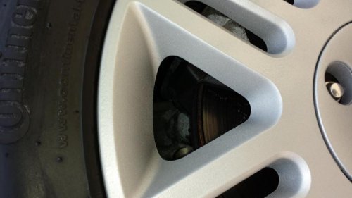

Here's the finished product. Just a little bit too dark. Being my first time the results were better than expected, but I need to practice the glossifier. Didn't have the sheen that was in Fonzie's video. Also I accidently bridged a gap between the center cap and wheels, something I have to be careful with next time. 20130614_141117.jpg20130614_141123.jpg20130614_141130.jpg20130614_141137.jpg20130614_141206 (1).jpg But seriously this job is very easy. I wasn't happy with the color, but the results were great. I'm giving anthracite a try now. 20130614_141718.jpg

In the areas where I applied it right, it looked like an alloy wheel. Fonzies looked great, I think if I applied the glossifier better it would've looked different. This wheel has a weird finish to it too. The face is a different finish than the inner spokes.
