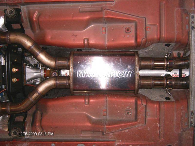

Access Door Dimensions
Hi,
Hi everyone.
This is my very first post on LVC. !!! Whoopie !!
I am "reviving" a (sat-outside-in-a-field-for-six-years) Nordic Blue '93 MK VIII.
These revised dimensions (below) are really VERY good, well honed, for my slammed Gen 1. You can count on them being accurate. Have NO idea about applying this dimension to a Gen 2, experienced Members please comment.
And, for a URL to get into my Photobucket shots, use this :
http://s1092.photobucket.com/albums/i406/dowto1000/?start=all
Note: photos in Photobucket album are of my first attempt, "revised" diagram is a bigger better access door.
Used a Dremel tool, cut off disc, and was VERY careful not to go deep in the two circled areas, due to lines below. The cut out piece is oddly shaped, and it becomes the hatch, and just add tabs to it around the periphery. I also added a new connector, (for the fuel pump's four wire leads), that I could access without getting under the car.
Hope this helps some owners.
