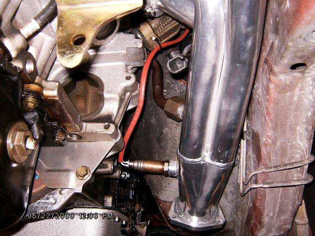

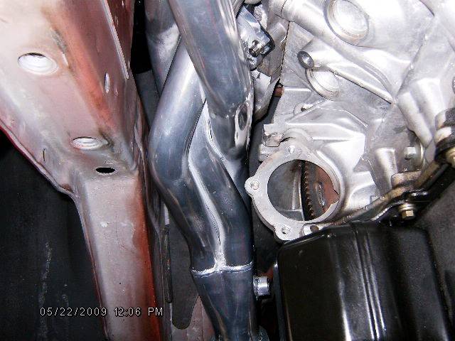

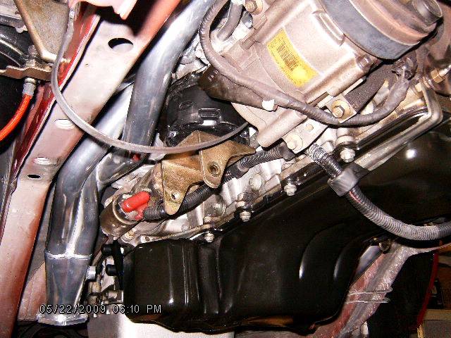

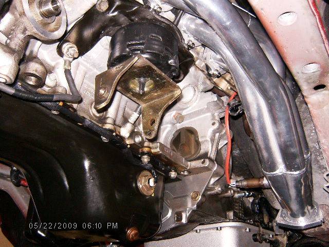

Its because they were made for the car, not a Mustang... the Marks have very tight clearance for headers so to make them fit they had to be built around the car....
The DOHC is also a very tight fit in a Mustang. The biggest problem fitting headers to the MN-12/FN-10 chassis is the steering shaft location. And then there's the issue of the Mark VIII specific smog fittings.
But, the Kid's right, not much room under here.
Looking at those pics just made me decide I will never have headers on my Mark. Even if I was swapping the motor I would be very hesitant. Thats so close that I bet there are occasional rattles fron the times the engine twists.

HOLY :q:q:q:q THAT IS SUPER TIGHT, right up against the frame. what exactly is the smog thing your talking about dlf, what headers are those, the kooks shorty ?

With the solid rubber engine mounts I installed, I have had no such problems.
They are Stainless Steel Kook's 3/4 Headers. The EGR fitting and the AIR fittings are different than the 96-98 Cobra's.
