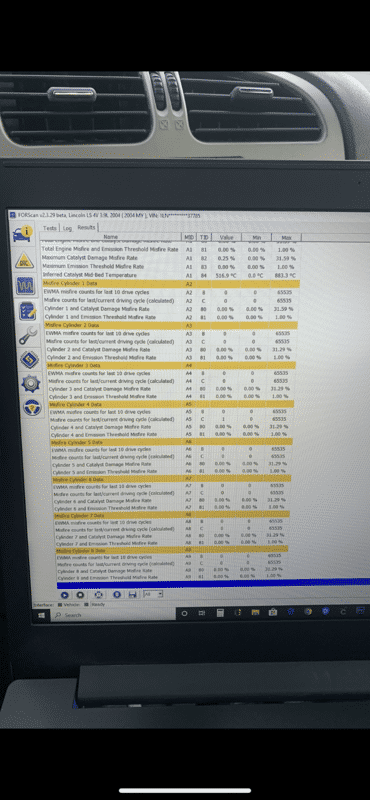

What is inferred catalyst mid-bed temperature?! Sumbitch is hotttt normal or no? If you can’t read it the value was 517°c and max was 883°c
I’m getting a lean code both banks as well. Going to check for vacuum leak and fuel issue for now. Any ideas to check on?

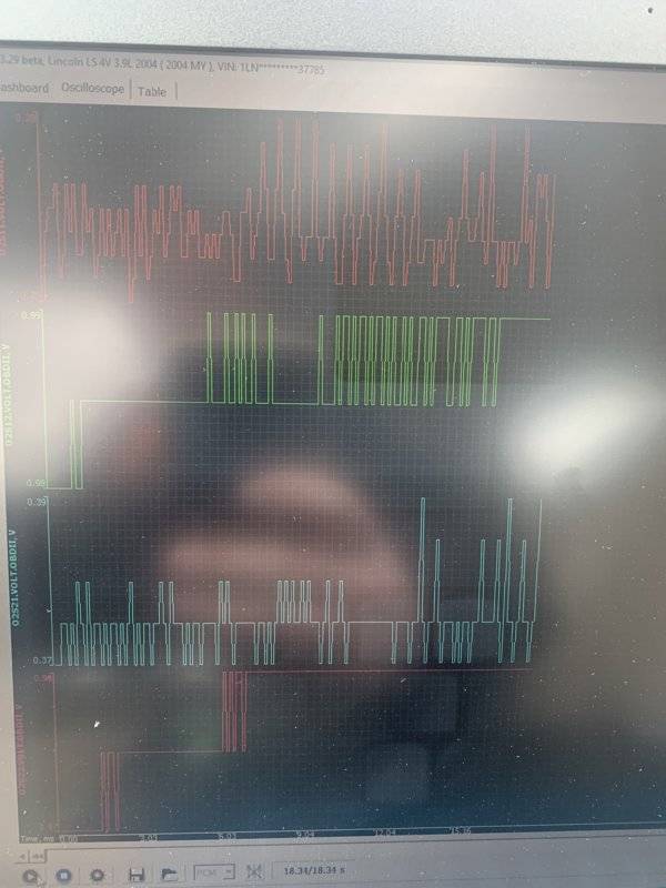

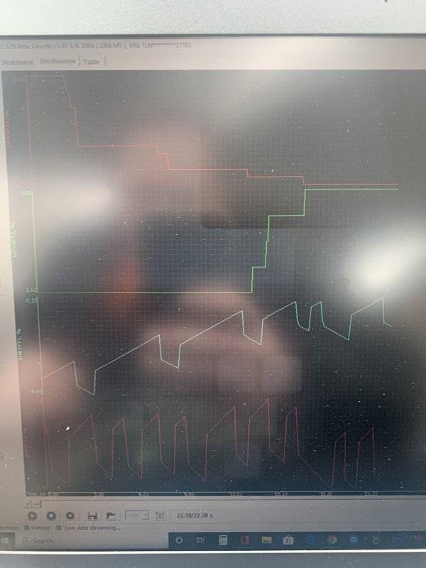

What does your O2 sensors read in live feed? Can you obviously see that the sensors are erratic? Have you googled what a Cat temp should be when operating normally? Then compare your CATS to the functional Catylistic Converters...YouTube has a ton of DIY CAT testing videos ...if car is running lean it could be many things ...the quickest way to check for a Vacuum leak is a smoke test at a shop with a smoke machine ...shouldn't be more than $100 if that

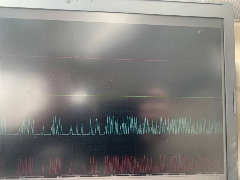

Im not thinking on anything just trying to shoot some ideas. Like I said I’m lost as to what is going on so I did try to disconnect the solenoids once the issue occurred. Turned off the car and disconnected them. Restarted with same issue so I’m not thinking vct. I’ll post a picture of my o2 love data and see what you guys have to say. It looks strange to me but I’m not an expert.
I also notice right when the car starts acting up it’s going into “drive” loop at idle. Not sure if that’s the same as open loop.

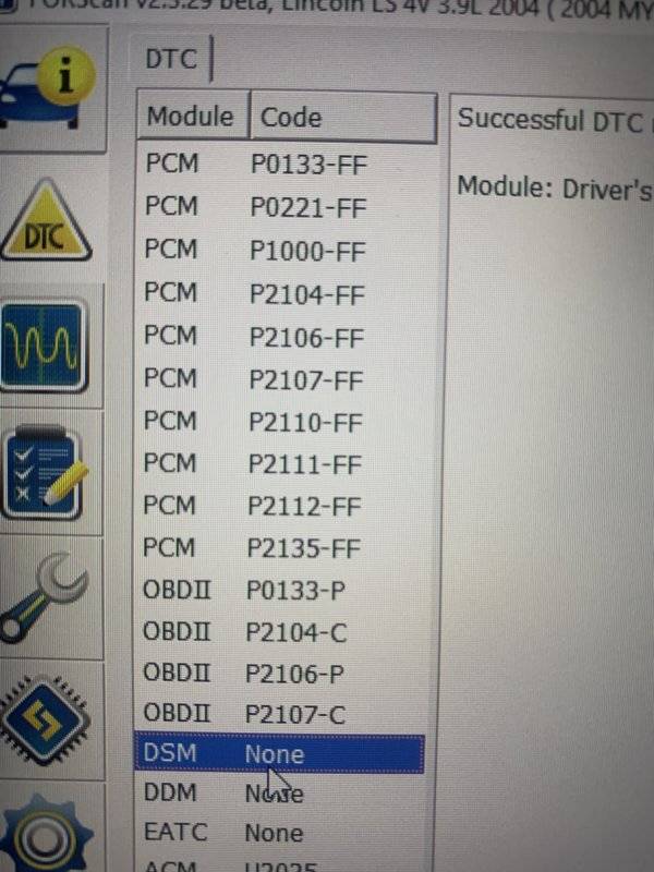

Do you have codes confirming the engine is running lean? If so what are the codes?
Intermittently. P2195 and P2197. Had P0133 a couple times as well. But the main codes I have are P2107 and P2110 which I know is common with coils.
