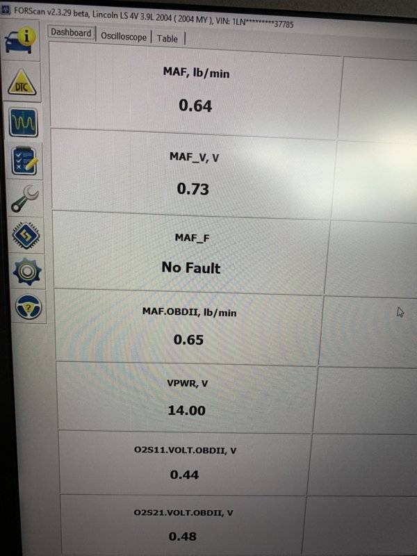

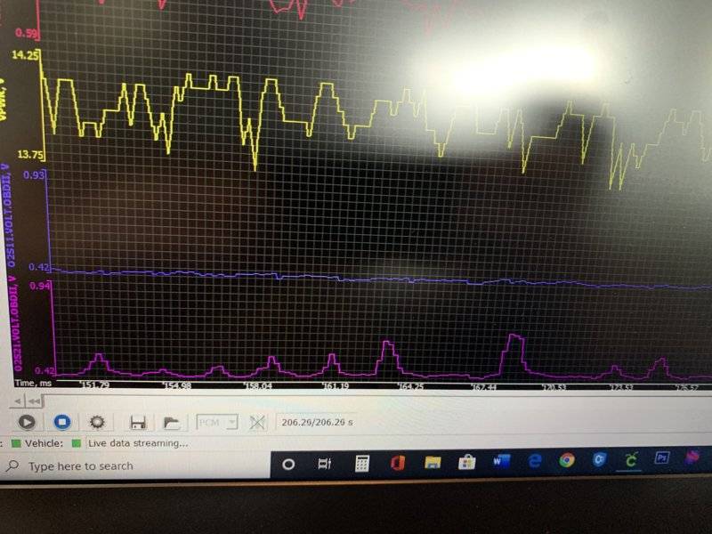

Here’s the voltage
Will you also check and see if yours will start and run with the maf unplugged. Mine may start, but dies right after.

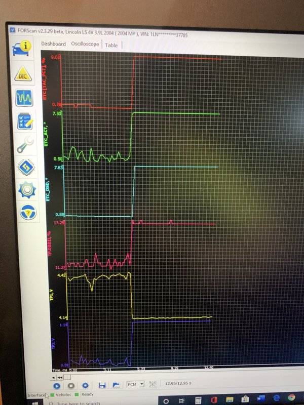

Here’s what’s happening to my throttle control when it starts running bad. From top to bottom
ETC [TAC_PCT]
ETC_ACT
ETC_DSD
TP.OBDII
TP1
