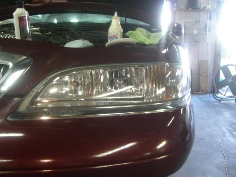

I've just used varying grits of sandpaper, and a buff ball for my drill with a few different compounds... I use PlastX to keep them looking new.
wet sand them and buff them with a variable speed buffer and mothers chrome polish. yes i said chrome polish, try it, you'll see. its cheap and fast and they'll look brand new.

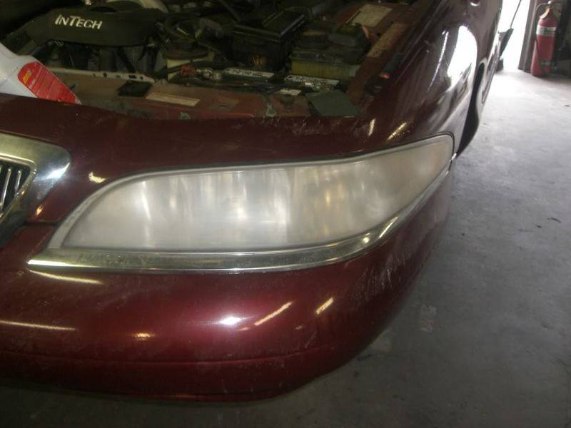

i have never had to redo any lights i ever sanded and buffed, everyone claims doing it the way i do they will just turn yellow again, sure, maybe in 10 years, but thats the same amount of time it took for them to get nasty in the first place. there is no avoiding florida sun, it beats down on everything, and no headlights i ever di turned yellow again. im not saying the 3m kits are no good, but i'll stick with my way, it works and its cheap.

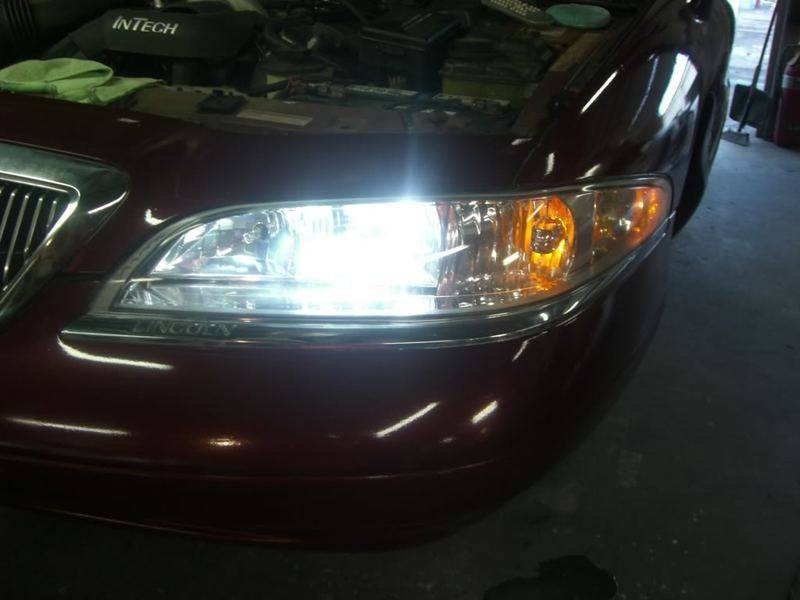

I confess, it was me. The kit worked exceptionally well for me. There are other ways to do this, Jamie's way is good, how can you argue with his results. For me, without any knowledge of what I was doing, the kit was perfect. The instructions were clear and concise and the different grades of sandpaper and polishing compounds were just what I needed to get through the clear-coat residue, minor chips and sand blasting effects from years of use here on the sandy/salty roads of NH.
Just take your time with it and don't get overly aggressive with the sanding and you can have the stang in night driving condition again.
