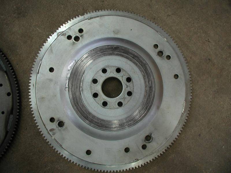

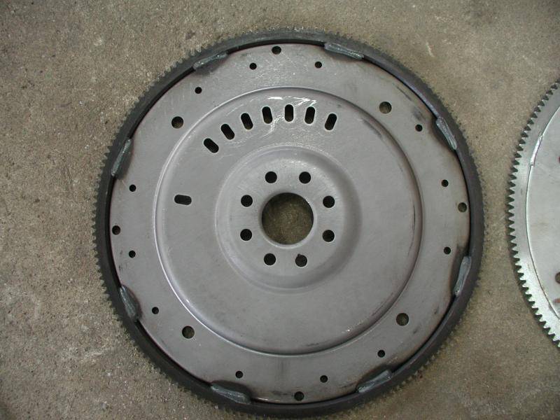

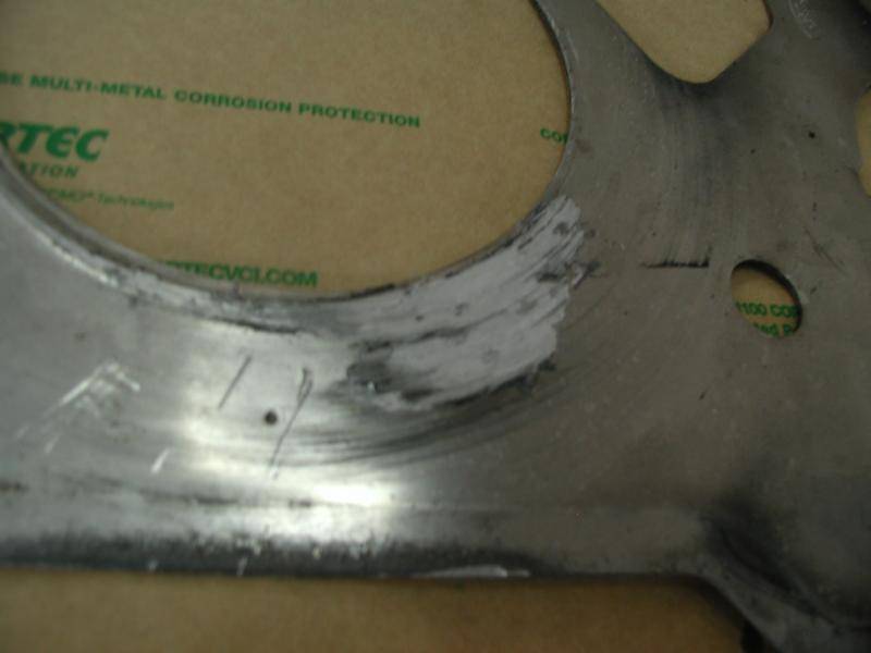

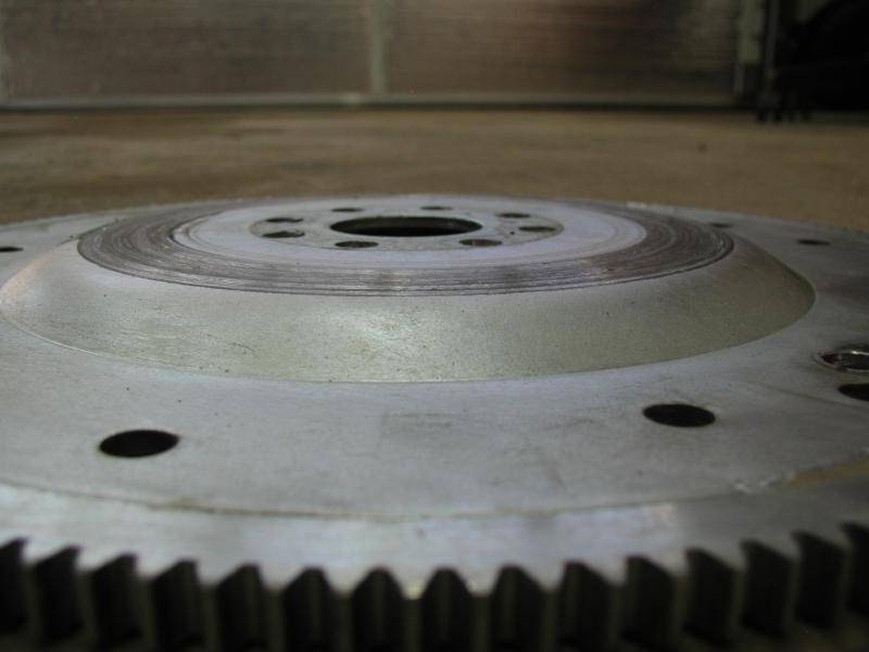

What flexplate are you using ? It sounds like the engine/trans alu separator plate is rubbing on the flexplate. I experienced this very sound once on a car that had an aftermarket flexplate. Worth looking into .... :confused:
Yep... been there before. It just took a little tweaking of the separator plate with a couple long pry bars to clearance it.
Not quite as bad as you pictured however!:eek:
