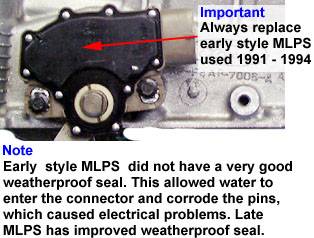

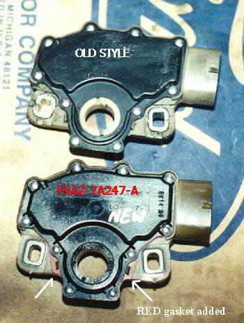

Dan is messing with me. Take the MLPS off before attempting the gear selector. :p
I can't set here and list all of this stuff one by one in my head. I forgot to mention, I'm not a guru too. :shifty:
Yeah, could have been but honestly, I wouldn't swap out and install 17 year old parts, especially the MLPS. Go new for sure on that like chicken is suggesting. Call Maxx or check rockauto and get real OEM parts to go back in. A lot of stuff is updated now after they figured out what was good and what wasn't.
