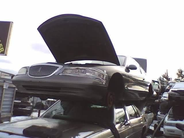

I know that Standard Auto Wreckers in Markham has a GenII on the stacks, maybe you can get the pan from them. They are online as well but the car is in the Upull section.
I was just at Standard 2 weeks ago and the Gen2 that I saw back in Dec/Jan was gone and I didn't see any other Mark's
I saw this one back in late Dec, early Jan:

Well I was there maybe 4 weeks ago I guess they crushed her.
I was going to head back this weekend or hope that it was still around for the $50.00 all you can carry parts day.
