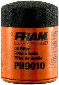

Since it sounds like this is your first oil change on the LS, be sure to check if any of your oil filter wrenches fit. The filter is in a tight spot and most filter wrenches either don't fit or you can't get enough room to turn the handle.
On my LS I have the easiest time using one of those "cup" shaped wrenchs that fit on your 3/8 inch ratchet and slide over the end of the filter.
I have a collection of wrenches, straps, you name it, that I collected over the past almost 40 years ofc changing my oil and NONE of them fit. The cup type fits right on but it is not a "One Size Fits All" so buy the one that fits.
Yah don't want to be surprised with an empty crank case and a stuck filter.
