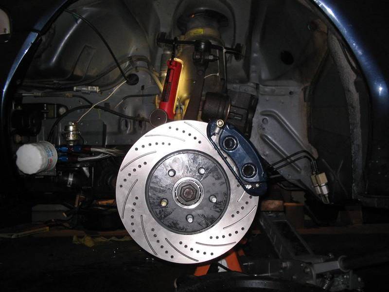

I Did the Moroso 23681 which is BY FAR the best adapter. I go a smooth hose adapter for the coolant and used regular SS oil lines.
That looks clean, the Moroso 23681 is the adapter that goes to the block, what adapter did you use for the filter in the fender well. Like the extra caliper too :)
Did you mount and extra oil temp gauge inside?
I just use a perma-cool remote oil adapter. the filters are all different and cheap even the nice Mobile1's... And of course the best filter of them all
