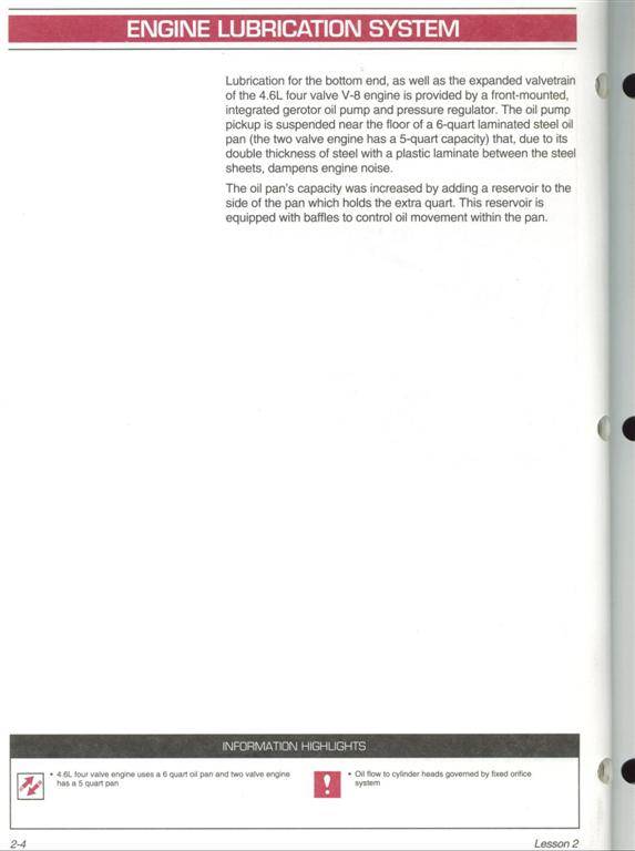

awhile back there was some discussion about the oil capacity for our Mark VIII's. some said 6 while others said 7. here is a page from the factory engine service manual that say's it is 6. just thought I would post it to help clear up any confusion.

The owners manual says 6 quarts or at the fill line. Mine takes right about 6.5 quarts at the fill line. My 2000 expedition also takes about 1/2 a quart more than it calls for to reach the fill line.
From my experience, the 93-95 take 6.0-6.25 and from 96 up takes 6.5.

I think our pans are baffled to help control oil starvation at the sump.
