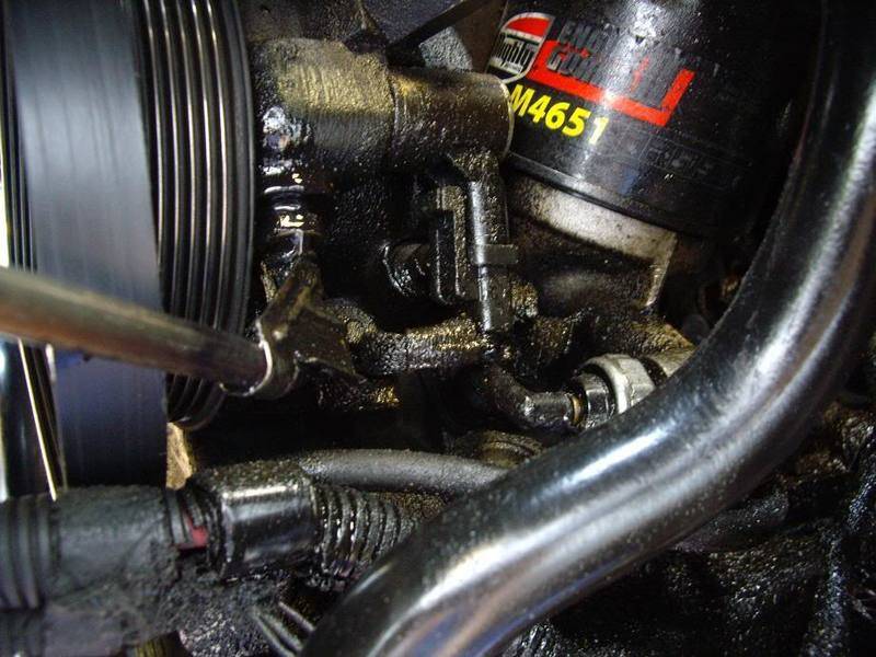

Now shes leaking oil :(

Near your oil filter or under it, I'm gonna say Oil/Coolant thingy gasket..it's under the oil filter ( and by under I mean, between the filter and the block) tucked up behind the PS pump, not terrible to do yourself..

Make sure you can find some freshly leaked fluid..after above stated cleaning has been done..degreaser and some high pressure wash, then you'll be able to see the area better, and the color of fluid will be a bigger give-away
as Ripped said he had a ps leak, but you said oil...
Which is it, red or black?

Yea ps fluid is red, oil is black however grime mixed with ps fluid will look black. Jamie completely degreased and cleaned my entire engine by hand and whole front end underside. The whole front end was spotless. The PS leak made the engine look caked up with black crap again just like your picture. So looks can be deceiving. The only telltale sign is the color of the drops on the ground, not the color of the stuff on the actual engine.
