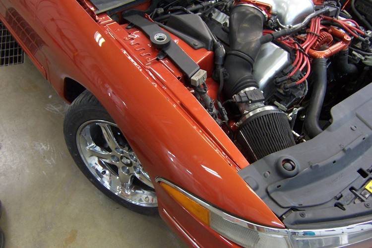

Here is a pic to show you.
This is off of my old 95'.
Mike
