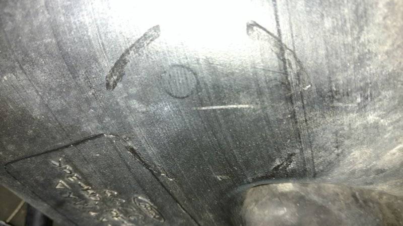

    I just noticed that someone has at some point used a jack on my gas tank or at least it sure looks like it. The question is would I be wise to replace my gas tank or should I use some type of repair kit, or should I get a good used one?

    Are you having fuel problems? It doesn't look like it is punctured from that photo.

    Having an issue with the fuel tank pressure sensor but other than that no. I have to drop the gas tank to do that repair on the sensor so was wondering I guess should I get a used gas tank to be safe. I guess the only reason it scares me is cause the marks are pretty deep, but it might be hard to tell from the picture.

    Be aware there are no new fuel tanks available (that I or my dealer could find). If you want to replace the tank, you'll need to source a used one as you mention.
    I wonder if the tank was previously dropped on your car, hence the markings from a jack?

    It's so hard to say what happened it's something I only noticed when I had to jack up the rear this morning to check out my shock springs.
    I was most likely going used anyway I did not really want to drop $400 plus into a new one. I found one about 60 miles away from me for $75 where they pull it for you.

      I have not even looked for a new one I just found a good deal on a used A Grade tank for $75. Being the used price is that good for A Grade I would grab it in a heartbeat if I needed a tank.

        I think I am going to go the safe route by going and picking up that gas tank tomorrow. Since these parts are getting harder to find I might as well grab it while I can. To me the tank is questionable to say the very least and just because it's not leaking today don't mean it can't start down the road. Them gash's are a lot deeper than they look in the picture. And since the tank has to be dropped on my car to change the fuel tank pressure sensor then I think I would be smart to swap tanks cause obviously I don't want to have the tank dropped again later because of a leak.

        Sounds like you’re keeping this 1st Gen for the long haul Dale .....soooooooo...lol....what does your gut tell you? I mean ...If... the tank is coming out then you should go for a different one if you think the existing tank it going to give you problems down the road...it would be a no brained for me in the Midwest to drop in a different tank because the salt would eat that thing away ...you however live where no salt is used or not as much as Minnesota so there isn’t always that to consider ...but........and there’s huge....... But!...make sure before you buy the used tank for $75 dollars it’s not going to give you problems ...bring someone who knows what to look for ...experienced person with knowledge ...just saying...because it would really suck to drop the tank and have a problematic tank and then have to drop it again

          Oh I agree but I can take a flash light and inspect it myself. I don't have anyone that could go with me that knows what they are doing. The boneyard has good reviews though so I trust them. But I will inspect it... the best my eyes will allow. And yeah since I have done so much work I hate to get rid of it at this point unless someone comes with a decent offer.
