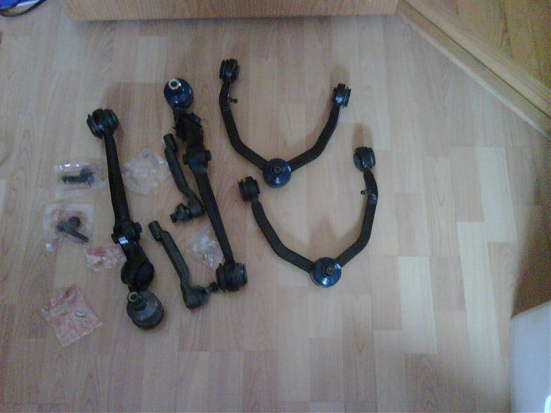

You need these>>>
Mine just came today!!:D
