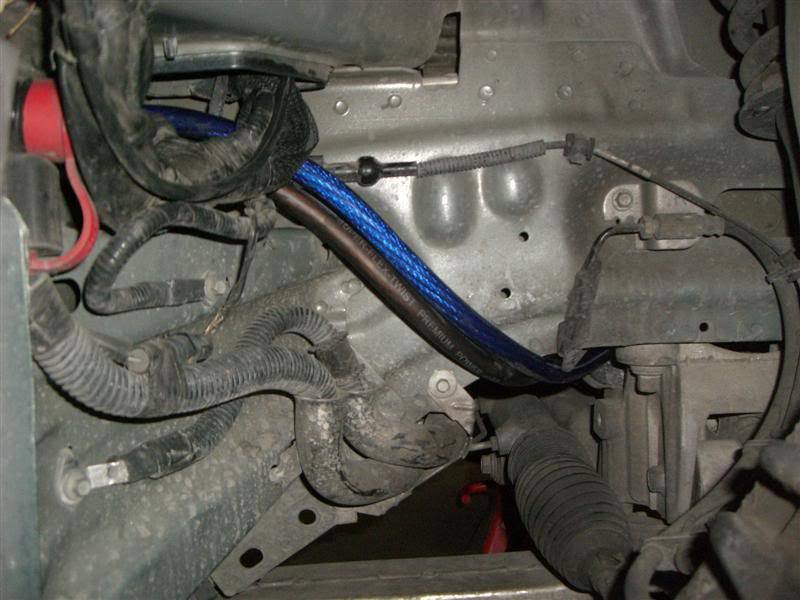

There's a good chance that its loose or corroded wiring at the "B" terminal. I say this because the charging current from the alternator passes through that terminal too. It would explain the earlier dead battery issues.
Is the "B" terminal under the passanger side wheel well? How hard/How do I take the plastic off?
Taken from this tread: http://www.lincolnvscadillac.com/showpost.php?p=877948&postcount=64
Thanks for the help! I can't get the car in untill Monday so I might as well try a few more things! :)
No, the B terminal is on the solenoid on the starter motor. It's pretty easy to get to if you safely jack the front, right up.
