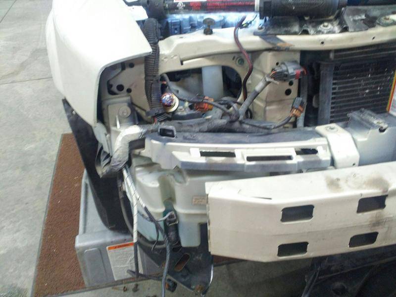

I tried to fix the wiring issue but got stuck. I was hoping it was going to halfway easy to figure out. Once I got the bumper off, I wasn't sure where the wiring harness that was talked about was located. The wires were definitely wet.
the main harness wire that is laying diagonally (with the white paint on it)
remove the tape to expose the wires in areas where water be able to build up and look for wires corroded green.
didn't you say your front wheel rubbed up into the wheel well? need to check in there too, it's all part of the main harness that connects to the ECU and FEM.
I removed the entire outer layers of tape, then I used a soldering gun to mend the wires and then used hockey stick tape to wrap it all back up, then a layer of electrical tape.

I removed some of the tape but i didn't remove that much of it, I wasn't sure how far I needed to go. The wires were wet but I didn't see any green wires. My side marker lights were terrible, I don't know how long they have been out.
Would it be possible to cut the wires at the bend and run it to the fog lights?
My tire never rubbed but I had an issue with the main power wire connection in the passenger side tire well along the fire wall.
I'm going to attempt to fix this wiring issue again this weekend but want to clarify where I need to splice the wire.
Do I need to follow the wires back into the fender any further to splice the wires or can I splice them at the bend (with the paint) and run new wires to the fogs from there?
Mine were corroded enough they had to remove the fender and splice further back...
Thanks Joe. Do you think its possible for me to run new wires without having to follow the old through the fender. Insert new wire from the harness bend (white tape above washer fluid) down to the fog light connector. I'm unsure if it needs to run through another harness or something behind the fender. I'm hoping I can just run new wires straight down to the connectors.
