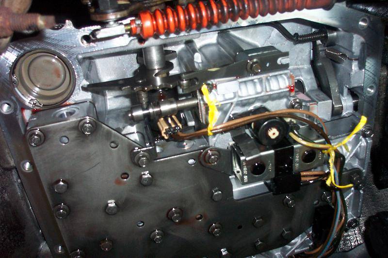

Ok, so I fired up my car after getting it all back together and guess what - no gears!!!!
I hooked the selector lever up to the very first space on the selector piston thing.
Seen here:
Anyone have a diagram of how it SHOULD look hooked up?

You likely misaligned the shift valve with the 'rooster tail' shifter.
Drain the fluid and pull the pan to inspect your work.

As for the selector it should be on the first notch, its actually the only one it will properly extend and fit in in park.
