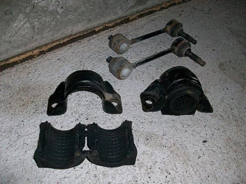

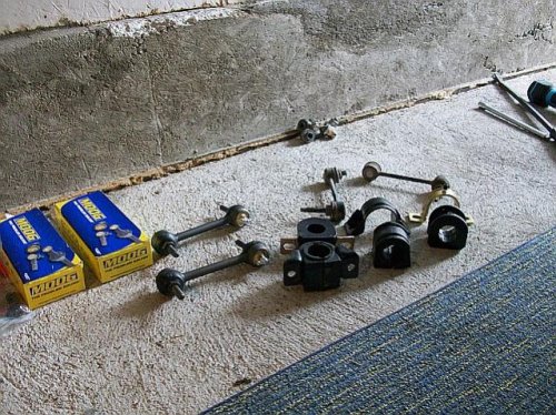

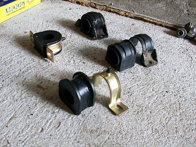

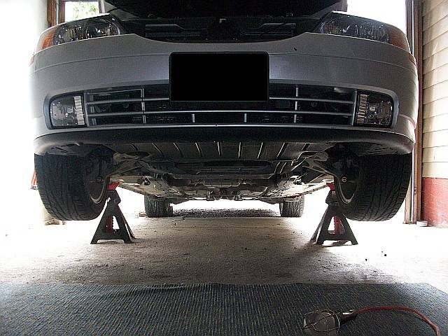

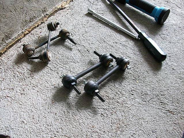

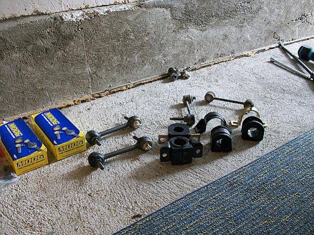

    01 LS V8 GEN I - Re & RE swaybar bushing w/ end links
    Pretty straight forward, worked mostly from above, had second person below fitting the socket.
    Used 3' extension, swivels from above on passenger side. 13mm closed rachet wrench from below.
    Passengers side - DCCV on it's bracket lifted out of the way.
    Drivers side - Entire airbox removed but not really needed.
    Swaybar Bushings and Endlinks in less then 3hrs ( no beer )
    ~ end results = no more knocking, stiff and tight steering.
