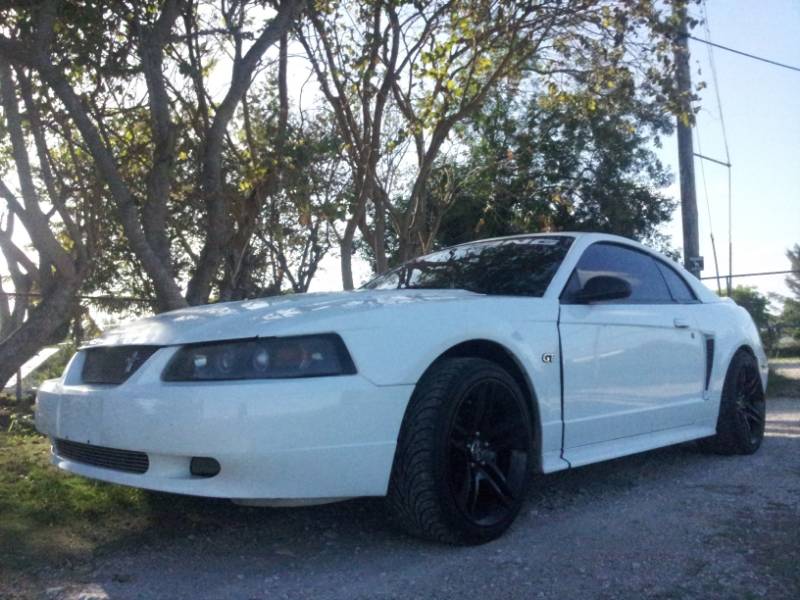

Ok guys I need help from more experienced hands. I just got this 2000 Mustang GT & believe it or not I bought it for $1,500 with a blown motor. The body is straight as an arrow. Wheels are insane. They are 18x10's front & rear on 1.5 inch spacers. It has over $2,200 in performance suspension parts & wheels alone. It's a 2 owner car with no accidents. We want to install a Mark VIII motor in this puppy & create a Cobra clone with the right heart but I've never done a full swap before. We don't just want a cloned shell with a SOHC, we want a nice DOHC in there. Ok, back to the Mark motor thing... I know the Gen 1 motors have a bit more power but I think I'd be more satisfied installing a Gen 2 motor.
What do I need to do first? I'd like to find a nice motor with no more than 110k. Nothing too high. Something I know I can install & not have to worry much about. I'm assuming I should also get the ECU from the same Mark? Anyone feel free to chime in. This is a slow project for the next 8-12 months.

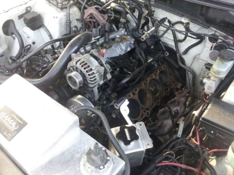

looks like there is a lot missing from that engine bay. i'd be watching the yards for a complete car to come in, then look for whatever you don't have.
Nothing's missing. It's all in the trunk of the car. Everything's there to rebuild this SOHC but I refuse to do that.
