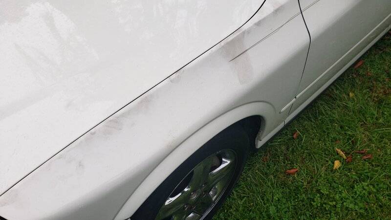

This is how you can tell that she's been in the shop recently, cause she always comes out looking filthy. My next LS is gonna be black for sure .

Third... I'm not impressed with the greasy/smudgy hand prints on the fender. Very unprofessional. They could have at least wiped the fender off... or spot washed it.
Well, time to find a new shop.....I wasn't impressed with the state they left the car in either.
