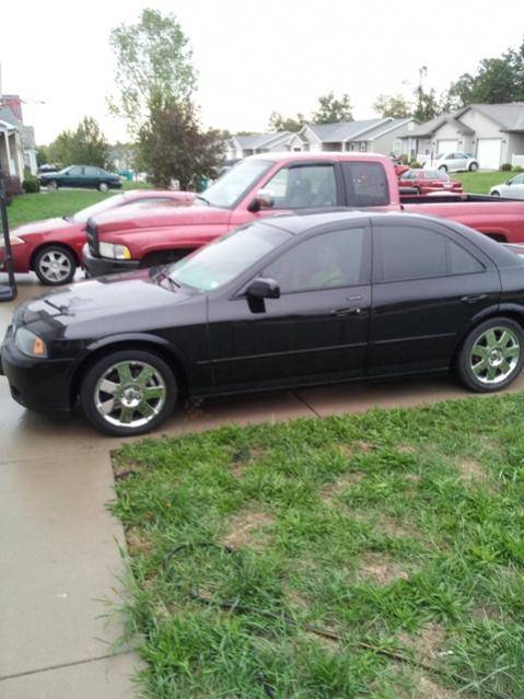

Someone said if I didn't post pictures it didn't happen. So, here are three pictures I snapped really quick. It has 84,000 miles on it. It looks and rides great. There is a vibration of sorts and a slight grinding noise (hard to explain) at the right front of the car. The dealer said to bring it back in and they would look at it. Other than that, everything else looks great. Of course, time will tell. Any suggestions on what to look out for and inspect on this 2005 LSE? Thanks!

It might be a front wheel bearing. Are those 16s or 17s? Nice looking car BTW.

VERY NICE!!!!!!!!!:cool: Good pick up. Need to post better shots in the near fututre.:D
Do you have the 05 LSE? Yes, looks like yours. Sharp car you have! The rims look nice. What are those?
Stock '04/'05 LSE wheels. I believe they are the same as the T-Bird.
The LSE wheels are the same as the T-Bird wheels, but a different center cap.
Skullkrushr has 19" Jaguar wheels on his LSE and they look great.
