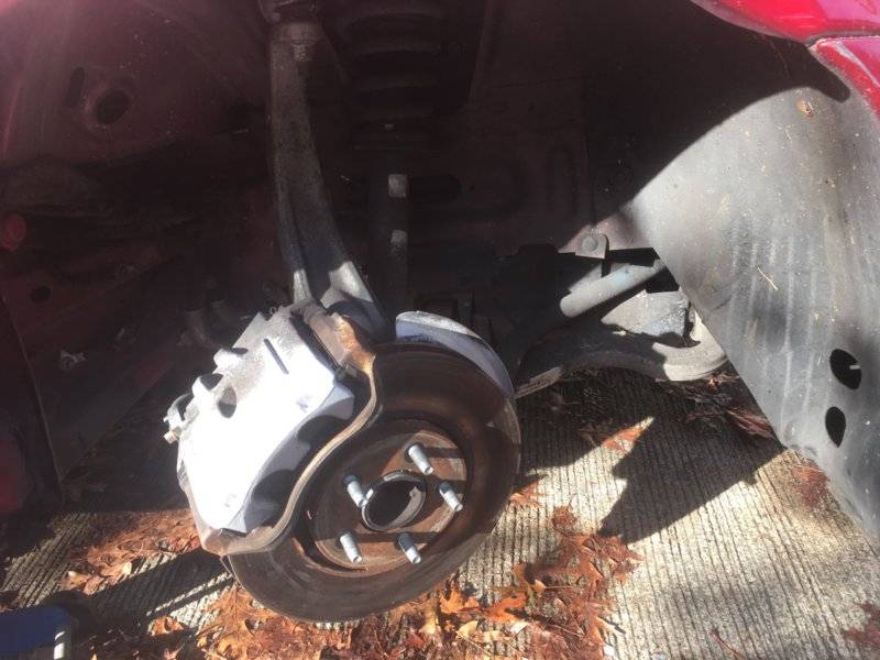

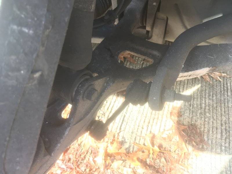

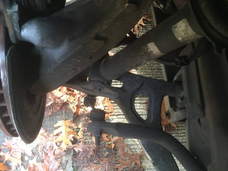

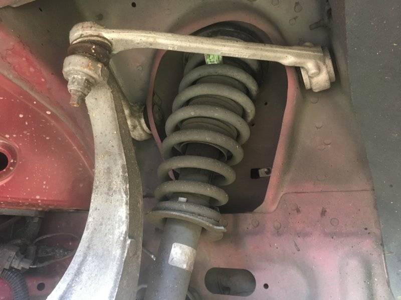

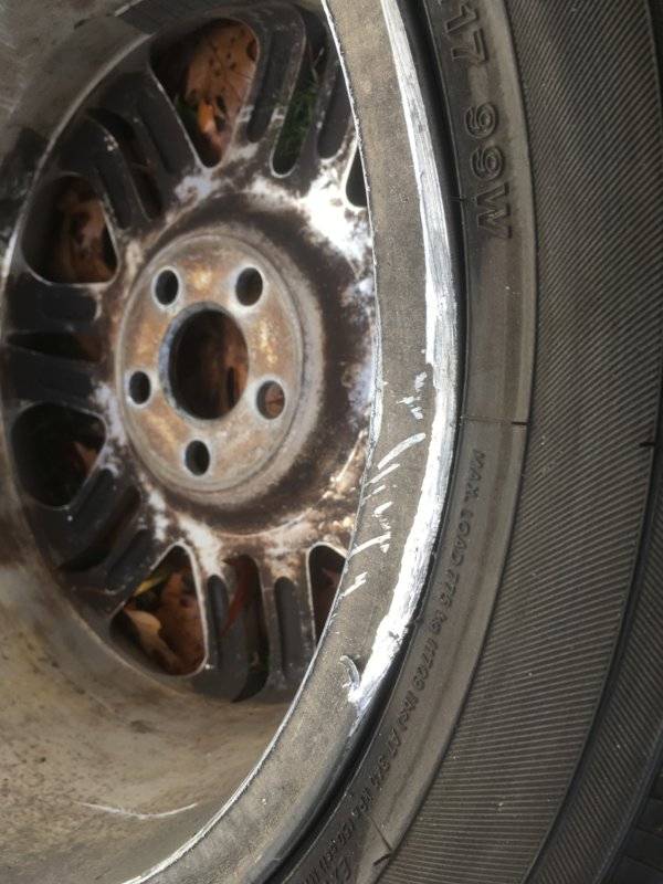

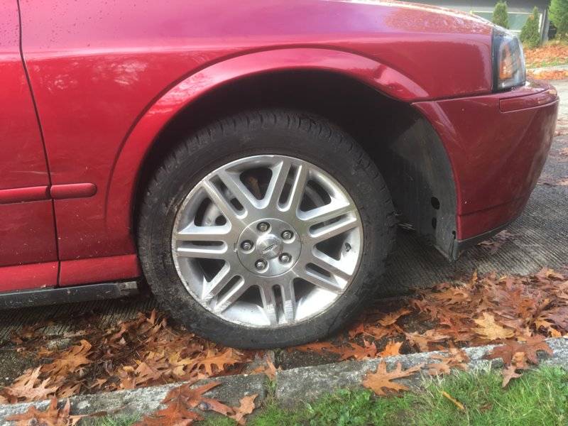

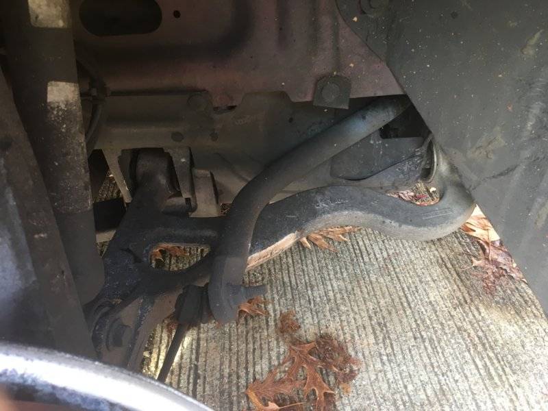

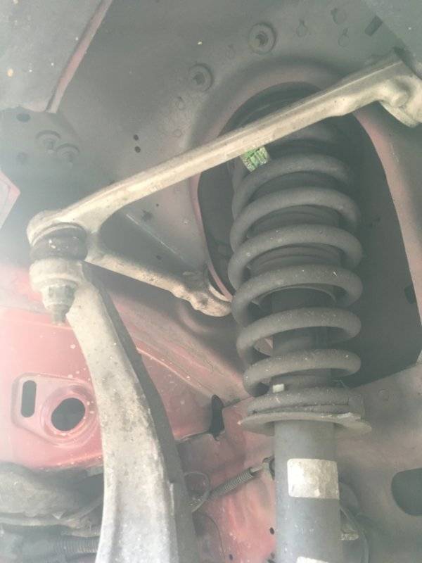

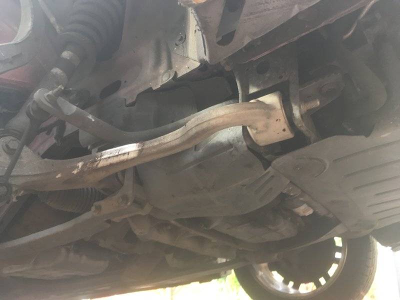

    65D1D287-0915-48CE-AA58-F81684147C4B.jpeg 4246B040-A0CF-4A5A-B39D-7E612FBB5EEC.jpeg D2E26F35-874E-4DD9-9F0F-115E5EF35C15.jpeg 804948E8-BF2E-4800-AA81-7AD19500F29E.jpeg 8BC8CA11-890E-44DA-B2C0-640B26B1B796.jpeg DA5BB82C-2D1C-4ABB-AEF3-57EB4E64DF2C.jpeg 77DF3839-3844-4EA4-9543-4D27551687CF.jpeg 6FC202D1-5D68-471B-B4C6-8EB7049AC575.jpeg E3846787-D7BB-4B8C-B2C3-F279BF6C4B9A.jpeg 43EB2B99-790F-4EEA-BEBC-7454FF7A8E6F.jpeg Ok, so it turns out that to upload photos, you press the upload photos button.

      This is the front wheel. AmsterDutch, I'm disappointed... :)

        Maybe it's the angle of the pictures, but the knuckle doesn't look right to me. While the upper and lower control arms don't look bad, I would definitely replace them. (It's not fun at when a bushing in the lower control arm fails.) If not new parts, then at least some from the junkyard. You also need the end link for the sway bar, go ahead and replace the one on the other side too. The rim and the tire need to be replaced too, and you probably should replace the shock or shock/spring assembly.
        Look up the parts that I mention above so that you can better identify the parts in your pictures.

            After looking at the pics which are top notch by the way....I would be Leary of keeping the lower control arm just because if the wheel shifted back it might have a slight bend and as far as the knuckle/Spindle these are aluminum and bend like straw if it’s bent it will effect your Caliper and rotor so I wouldn’t risk it Hub assembly is cheap and why not replace it if you can afford it always nice having new bearings end link is trashed as Joe said and until you take both upper and lower control arms off and really look at them for damage you’ll never know ...look on eBay for some southern state used shock absorbers MotorCraft only all the other cheap shock absorbers are garbage on this High performance machine...keep us posted

            Both the lower and upper control arms are bent. And like joe said, get the swaybar endlinks. BTW if you are near home, you can probably limp it back, it looks like it will probably rub on the inner wheel well liner, but I bet you could make it.

              Yes the lower and upper arms are both shot ...What I meant was sometimes when you look at them mounted on a car looks can be deceiving
