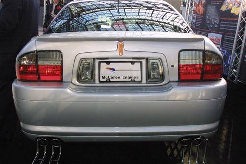

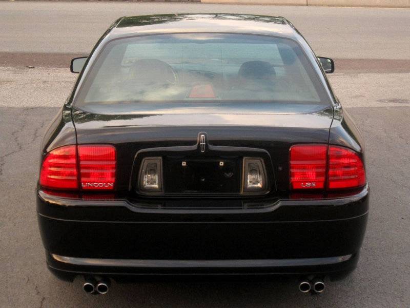

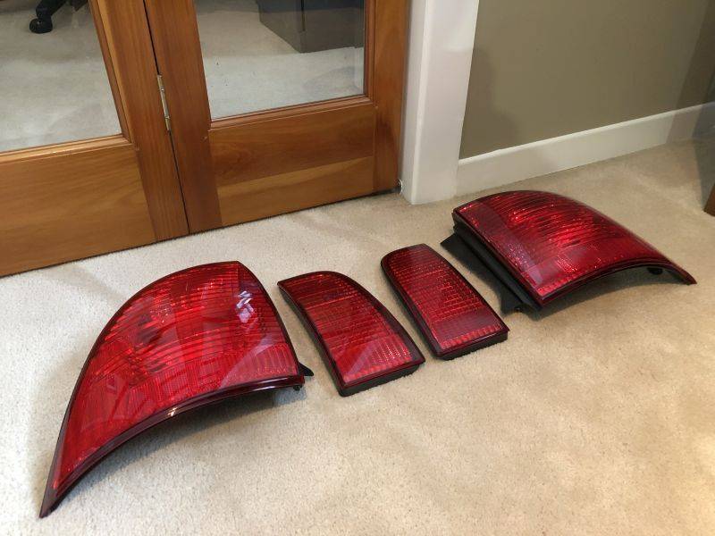

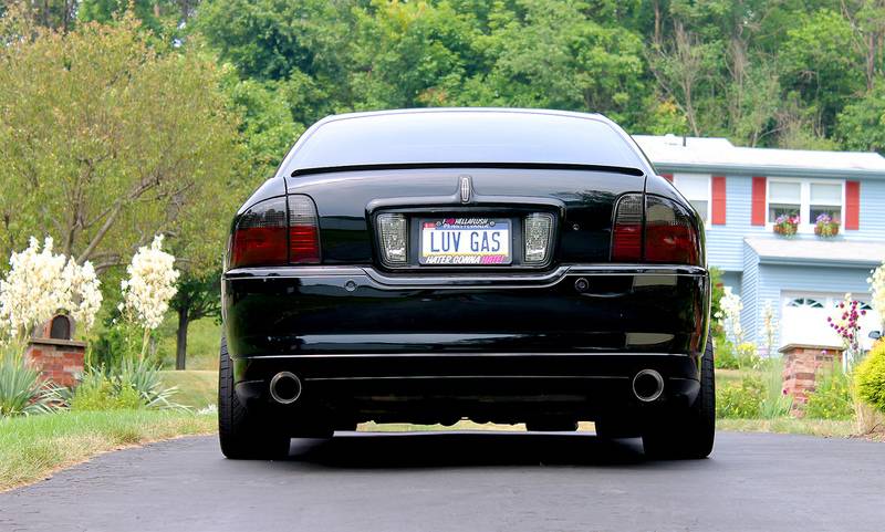

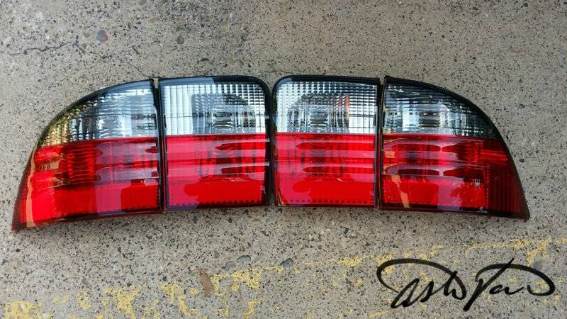

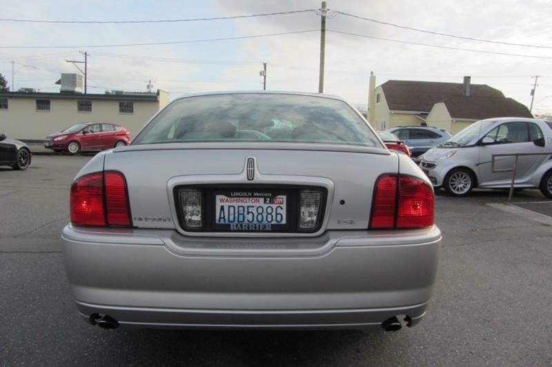

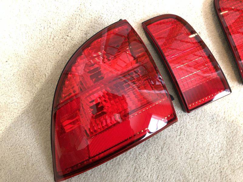

Bah, for some reason I had thought that the American taillights were always all red and the split ones were euro and Japanese.
00-02 = 1st GEN had all red 'ribbed' tail lights. Even the limited 02 LSE's did so.
to have clear top, red bottom (two tone) on a 1st GEN is considered EURO two tone.
03-06 = 2nd GEN has all 'smooth' standard clear top, red bottom.
(which BTW look awesome covered in some 'smoked' Lamin-x film)
in 04, for the 2nd GEN, amongst the standard LS'es,
they released a limited amount of LSE's which sported all red 'smooth' rear tails.
Best of luck with repairs on that front end.
As a Gen I owner my LS dream is to have a set of the EUro two tones with Lamin-X. It is my unicorn
Sorry, don't have a complete set,
just the inner lid mounted euro two tones. (1st GEN)
