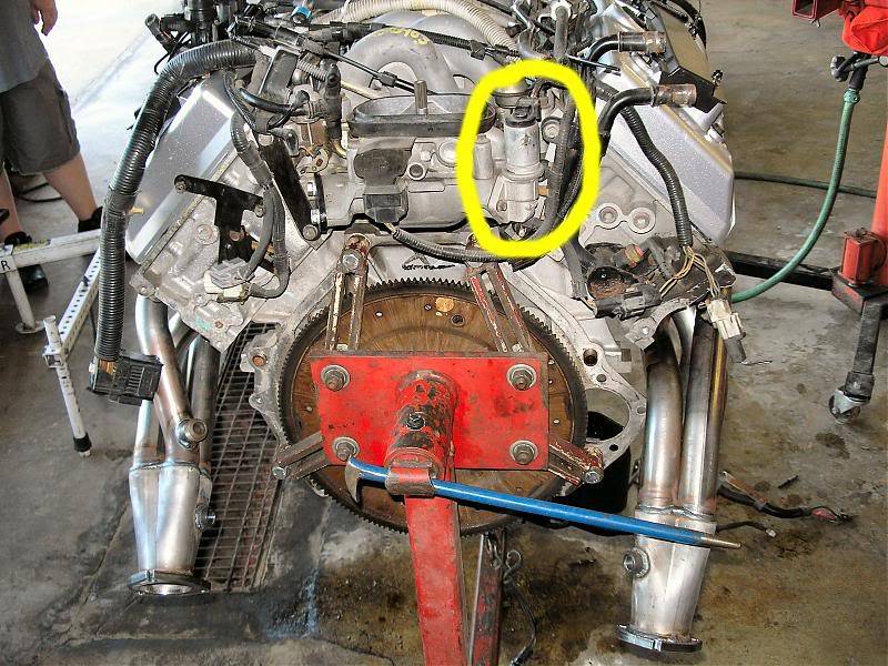

now I was looking into the issues with the IAC,
Where exactly is it located? Does anyone have a picture of it in its exact location..
Thanks
Bill
I think this is chicken's pic:

yup my pic, iac overspeed error usually points to a vac leak or a stuck imrc, usually never the valve so that would be my last resort. make sure your plug wires arnt arching across, ive seen it with brand new wires when ran too close to each other
