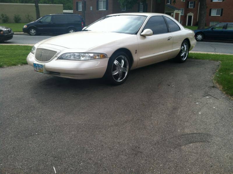

Heres an updated pic

Before I say anything, STOP DRIVING it that way! You will ruin that gorgeous Mark VIII running it hot. As prior mentioned, It could be a number of things. You need to take it out on a test drive. Let it idle in your driveway until it reaches optimum temp. Then take it out for a spin around a couple blocks. Bring it back home, Pop the hood & take a look. You should spot the leak. Remember, when the temp rises, these cooling systems develop high pressure so you are bound to see it.
