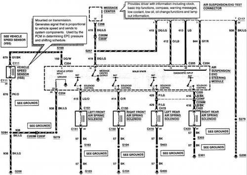

I am needing a 97 schematic for the VSS system so I can wire in my ER speed cal.
