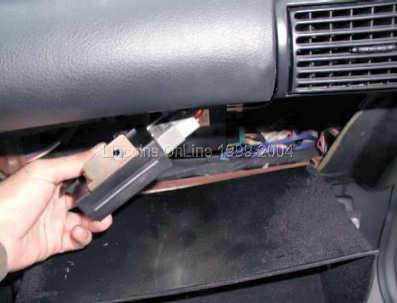

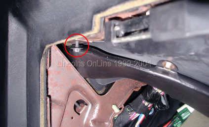

Stopping the error message, if it says (check headlight error) can be fixed by clipping the wire on the lamp out module. It's located next to the glove box latch and is held in place with one bolt, about an inch long.

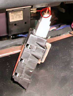

You will need to cut the brown/light blue stripe wire, which is circled here:

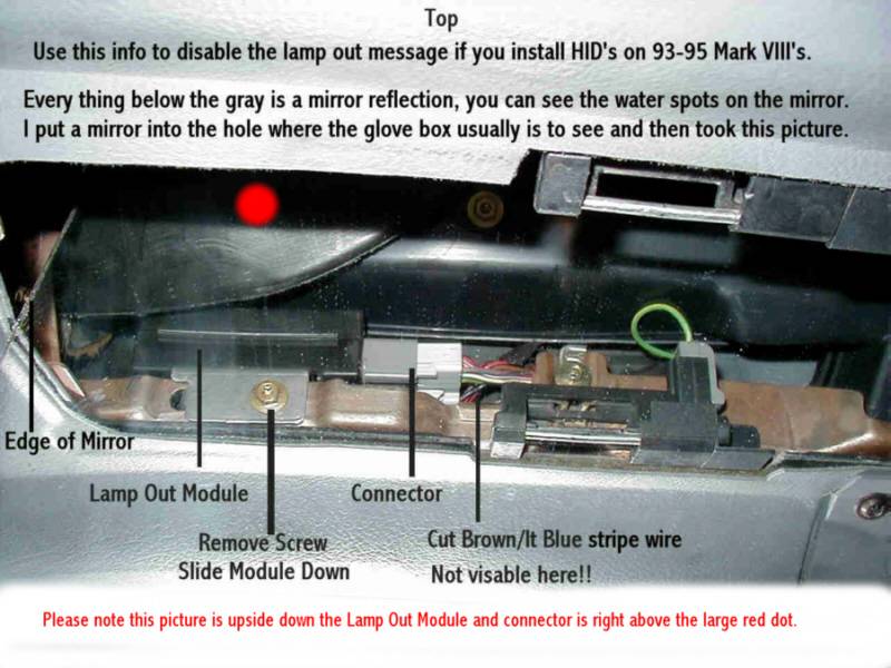

Here is another pic with a mirror so that you can see where the lamp out module is.
Re-install the lamp out module and then all glove box contents, re-attach the string on the side of the glove box and you should be done. You won't see the error message again and it does not effect the other bulbs on the car. If a brake light goes out, you will get a message letting you know. The wire you are clipping is for the headlights only. The wire you are clipping should be the same color on all years, not just 93-95's
