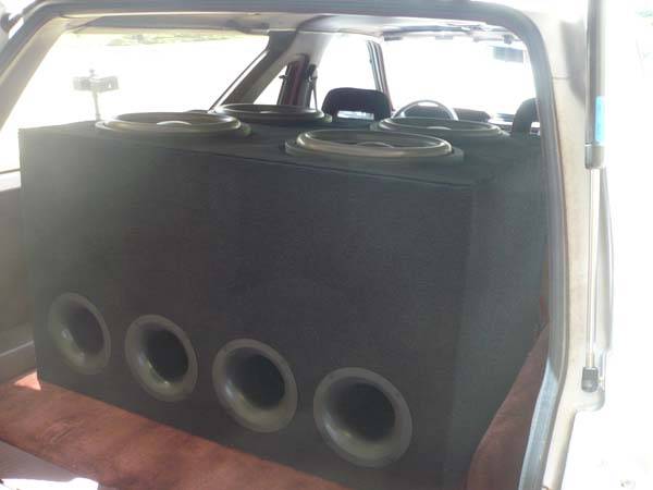

Why? The THX certified system isn't some stereo shop cobbled together system. Serious time and money was spent on the certification. Do some research on the accolades the system received when it was introduced in '03. Then again, it isn't a ghetto go deaf system........
