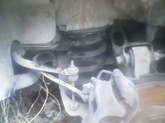

Rick, my name is Rick. Yes, the springs I took out of a 1997 Thunderbird Sport Coupe I have a thread on TCCoA that shows my spring install. Front spring/shocks/struts whatever just bolt right in, rear requires something to hold the top of the spring in place - I made these:

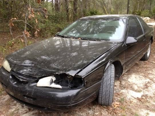

Here is the car I took the springs out of:

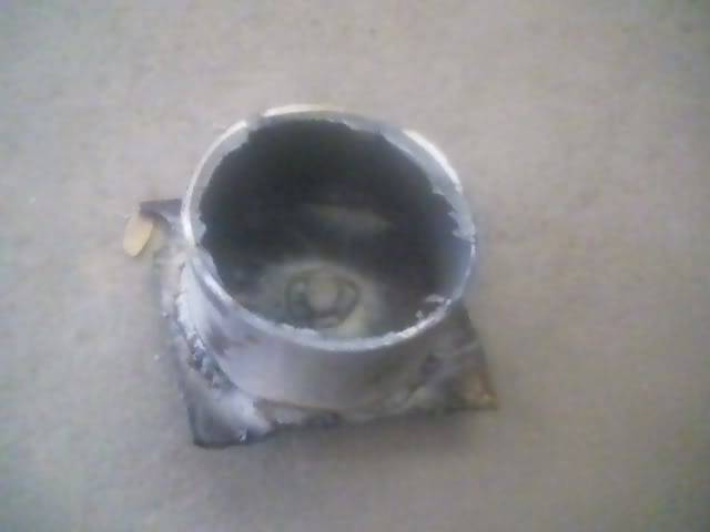

I have no idea. It's real easy to make those upper perches, here is where the metal come from for mine (an old flywheel - lol - I pounded them flat before I welded them):
And the round part came from an old piece of diesel exhaust that just happened to be the perfect size! Grabbed a couple of used bolts for the center pin and welded it all together!
If I had to do it again, I would weld a 3/4"-1" spacer because I want the back a bit higher.
