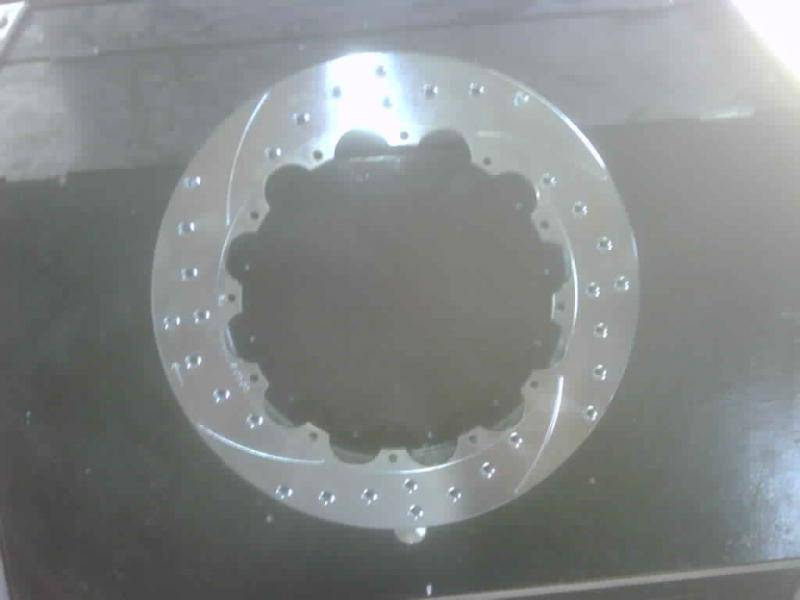

Just got by Rotors, Calipers and 1 Rotor Hat. I have already modified the rotor hat to fit. Now I have to do some cutting on the knuckle to make the rotor fit. More Pics to come.
4 Pistion Norrow Mount DynoLite Calipers
12.90 Cast Iron Slotted and Drilled Rotors
Custom Drilled Rotor hat

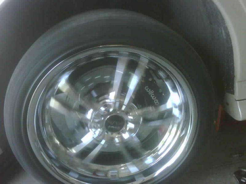

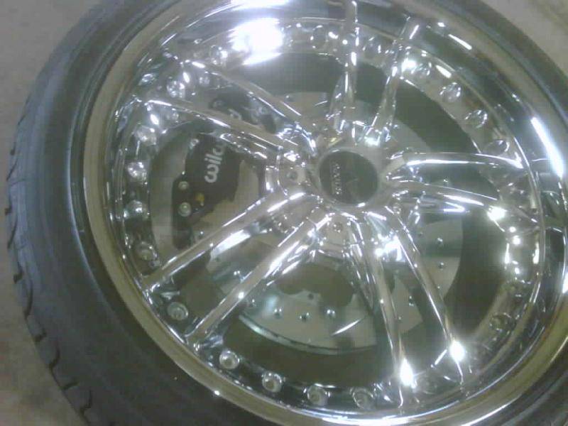

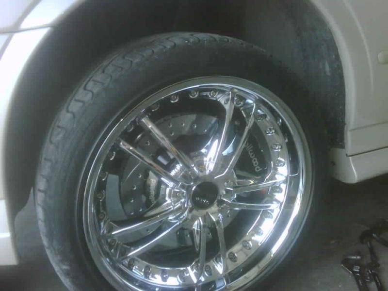

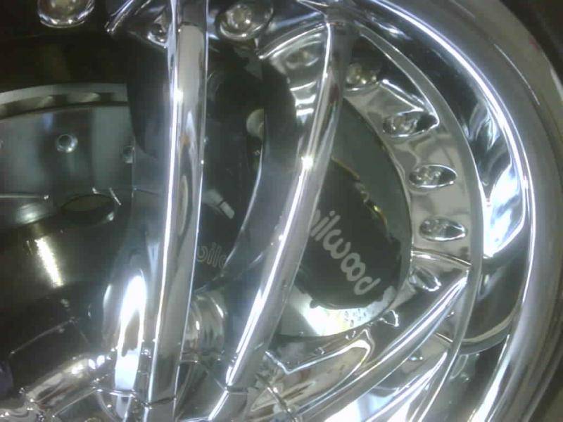

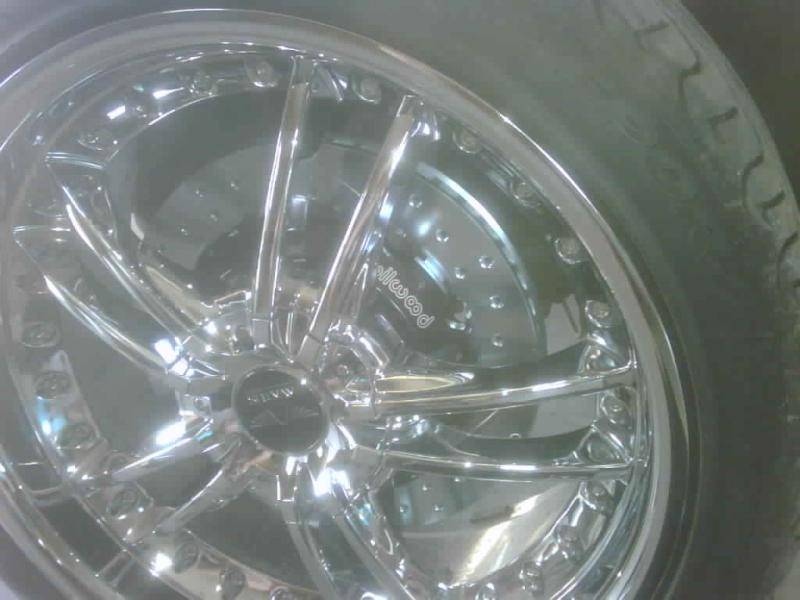

Getting the bracket welded today. Both wheels fit, the Avarus AV3 19" and stock 17" very little clearance but THEY fit! One thing nice with custom and can do whatever YOU want. Hopefully done by Monday of next week! Will take a picture of the bracket once its painted.

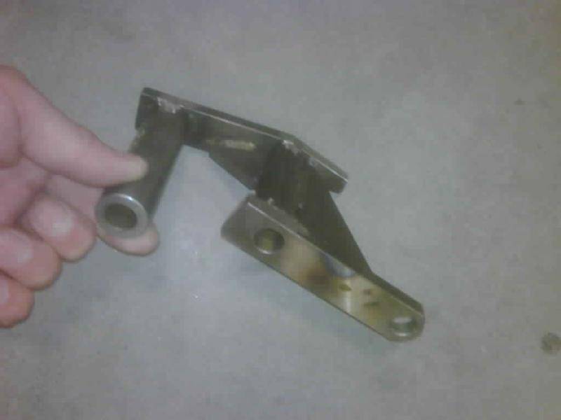

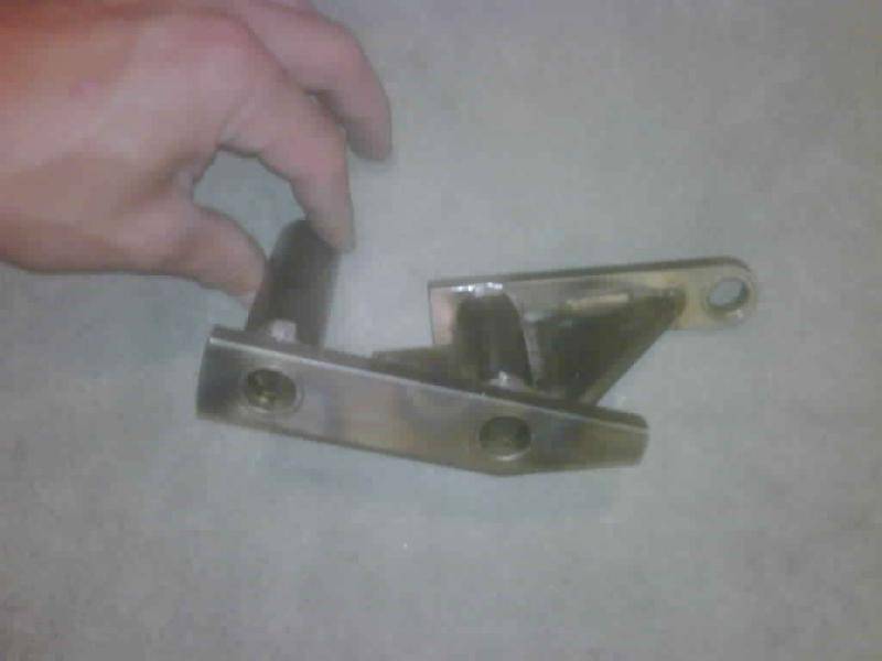

This is the bracket that I made to mount the wilwood caliper. Only part modified on the knuckle was I had to cut 1 ear off for the dust shield and I tapped the original holes with 14mm-20.
