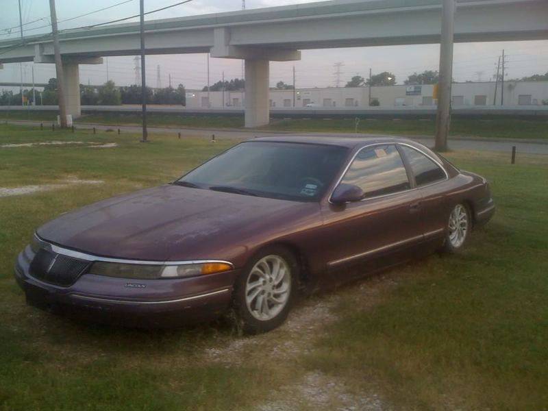

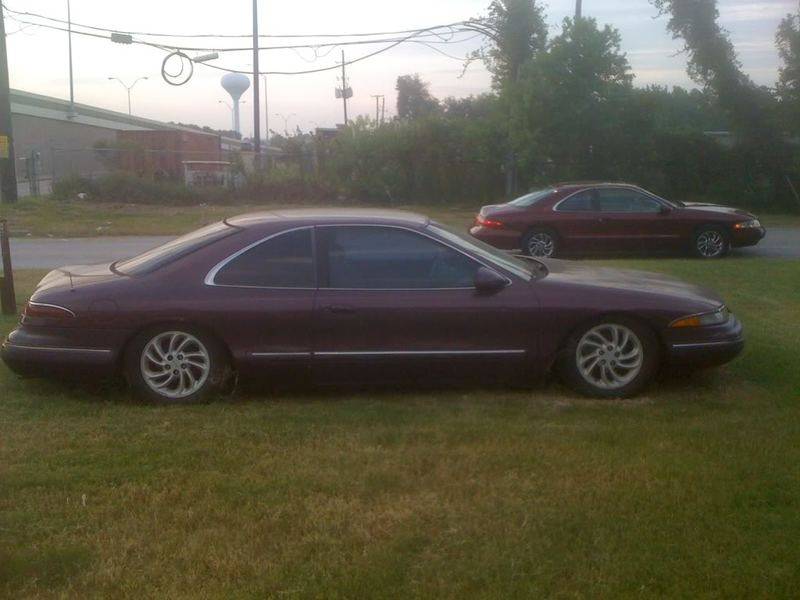

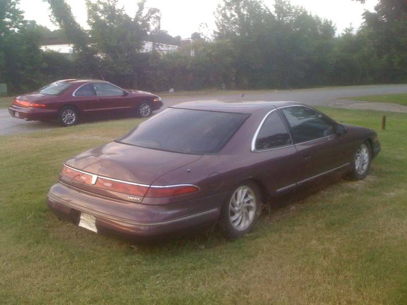

I have been pursuing this car for a few years. I could never get in touch with the guy who owned it. It sat in front of his grandmother's house for two years. Many months in the hot Texas sun. This is what it looked like when I first took pictures of it.

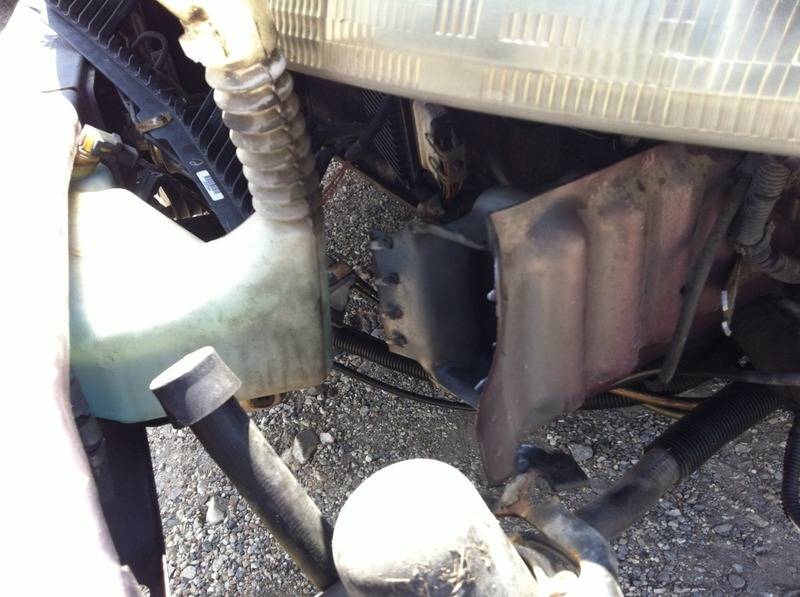

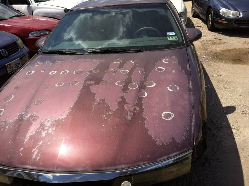

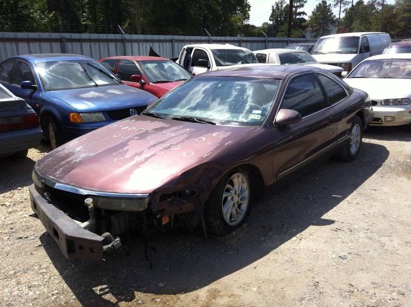

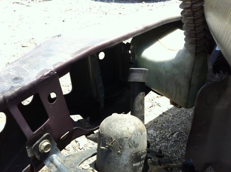

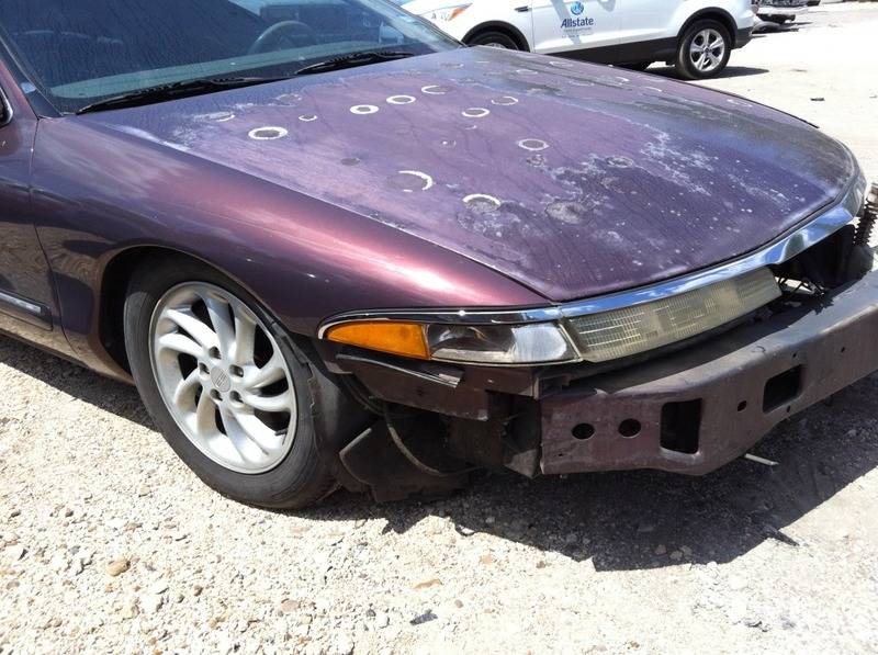

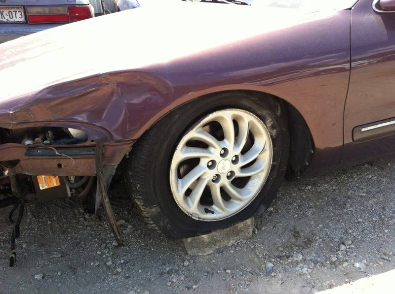

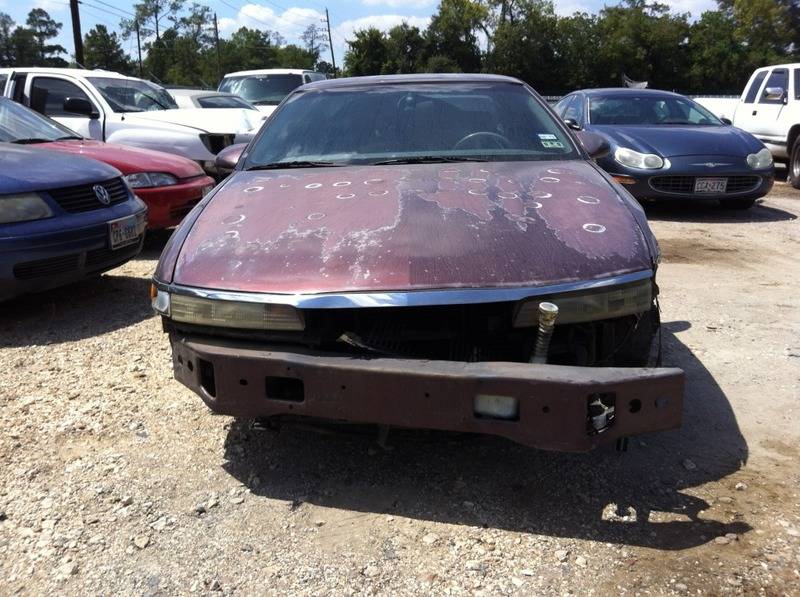

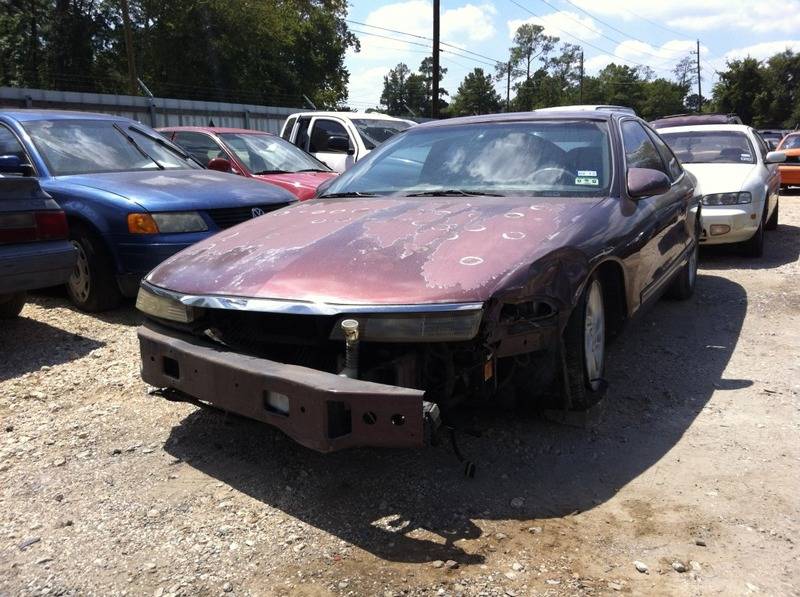

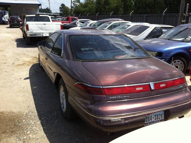

As of this month, he put it on Craigs list, and I missed it. He sold it to a lady for $1100. Last Thursday. Damn I missed it. This is not were this story ends. I see an ad on CL for someone looking for parts for a Mark, and someone to put them on the car. I am a bit curious. I have never seen an ad like this, so I call. It turns out that it's the lady that bought the 96 last Thursday. Turns out, she got hit three days later, and the car got towed to a storage lot. Now it's racking up storage fees. I went over to the lot to look at the car. Here is what it looks like now.
She got hit by an 08 Taurus that was try to overtake her and clipped her on the left side, pulled the bumper cover off, pulled the bumper brace out of it's spot welds, and damaged the the driver's fender. No damage to the hood. How does the damage look? It's a rare color, and I think would be worth of a restoration. What do you think?
It might be a rare color but it needs a complete pj.

Honestly, it looks like something that should be sitting in the junkyard. And I may be wrong but I thought the color was Rose Mist?
Hammer the supports on the frame flat again, then reweld it. Might take some convincing to get the other side to move back, but that looks like no sweat at all. Id totally do it for ya if I was anywhere near Texas. I say go for it!
I got a good drivers fender too if ya need one.
The one pic of the corner lens makes me wanna go out in the garage and bust mine out so they'll be clear and match the HID housings. If they were old, I would.
Greg, idk about that one man. I guess if you have the stuff, go for it but to me, it looks like it belongs in the JY to be raped.

That looks easier than replacing a core support. Make sure you're centered from side to side, put a bubble level on it, and weld away. If it ripped the flanges off the frame, id say it would be harder to repair.... not outside the realm of possibilities, but tougher. But from what I can tell from the pics.... get a propane torch, a set of six inch hand breaks, a few dollies and a good body hammer, and that thing will be ready to reattach after cleaning up the mating surfaces. Giggity.
