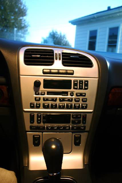

My look like 2003 dash
Alexbougie
Apr 4, 2009
487
Salaberry-de-Valleyfield
that my new dash
So, how did you mask the indicator lights on the climate control and what color/type/brand paint did you use?
Looks very nice!!!
I use dupli-color Ford Sliver frost, for indicator light on climate controlI paint over and after I remove paint for it with an Exacto

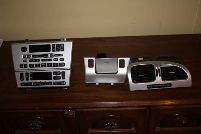

Why waste alot of time and effort to tape off all the buttons when they are easily removed, and as for the indicators it makes no sense to paint over them only to have to scratch the paint back off. The indicators are clear plastic lenses(not LED's) that are easily pushed out. Seems like he was in a hurry and forgot to tape off the top fin on the pass vent, I hope he sanded down the parts & wiped them down w/thinner before painting.
http://www.cardomain.com/ride/3322744
OK, I got the indicators removed. What did you use to remove the buttons? I tried with a jeweler's screwdriver and the blade is too fat.
I did mine back in 03 so IIRC I used a set of small blade screwdrivers that are usually used for repairing electronics(radio's,CD changers,nav units) You need (2) screwdrivers, the buttons are VERY thin plastic and have a little window cut outs on each side that slides over the inner plastic piece tabs. You need to slide the screwdrivers between the two plastic pieces on both sides before trying to remove the button face. If you try removing one side at a time it puts too much strain on the window and it will crack. I have my original black face unit somewhere in the garage, if I get some time tomorrow I'll dig it out & take a pic of the buttons removed.

Here's some pic's of the buttons & screwdriver's:
The main thing is to take your time! Do not push the screwdrivers in with alot of force as you will shear off the plastic tab. Slide them in easy and twist slightly to pop the outer button off the tab.
Thanks. Those are the screwdrivers I have. I will have to look for the smallest ones......
