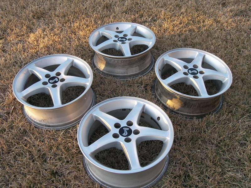

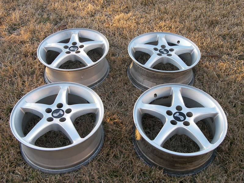

Doing my usual Craig's List search today, and I came across a set of Cobra R 17's in our bolt pattern. The guy bought them on Ebay thinking they would fit is Mustang GT. The Ebay seller screwed him. He decided not to pursue it. Instead I got them on CL for cheap. These are going on my son's Evergreen LSC. What would be a good size to mount. I was thinking 245/45/17.
Do I need a rolled fender for the rear?
You shouldn't with the 245 45 17s I have a set of 255 50 17s on mine and only once in a while I'll get a slight rub.

I just got cobra wheels and my 275/40/17 fit with no rubbing issues at all in the back. I went with 245/45/17 front and 275/40/17 in back.
The 245/45/17 is the tire I'm going to go with. The wells have a few scuffs on them. I'm thinking of repainting them before I mount them or chrome powdercoat them.

Are those Silver or white, I can not tell from the pics, they look white in color. Great find by the way lucky bastard.
greg if those are 17x9 i wouldnt put a 245 tire on them i would go no skinnier than 255 or the outside lip of the wheel wont be protected by the tire. a 245 tire on a 9 inch rim will be stretched onto the rim. if you are gonna get 4 of the same tires so they can be rotated i would do a 255-40 or 265-40. i'll take a close up of what a 245 tire looks like on a 9 inch rim because thats what i run in the front and i dont like it, the front rim is exposed to serious rash if i am not careful.
I like Fuzion tires, because the bead of the tire has extra meat around it to protect the edge of the rim. Plus, you can get a 245/45/17 in an H speed rating (making the tire more affordable) since I'm sure he wont be consistantly doing 150mph+ in his Mark...
