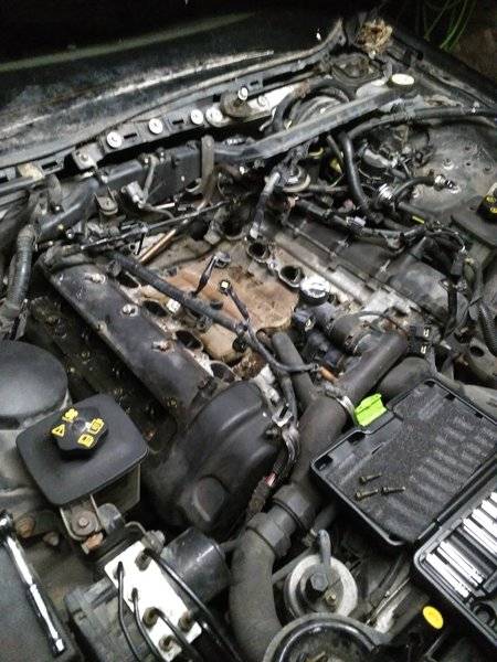

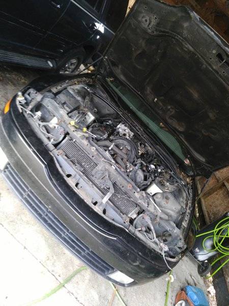

      A few pics of the start of my project. Removed intake manifold to replace it and the gaskets, pulled valve covers since i was already in there so i could check the secondary timing and tensioners.

      It looks like you are DIY mech. You probably got a great deal then! Just so you know, I had a 100k little old lady 2001 sport I picked up with all the receipts showing routine care. Yet so you know, I had to replace ALL the timing chain stuff. Not just the top. As it turned out my mechanic was right and it was the SECOND time in 100k that that all chains had been done. Anyhow I say that, because if you do it, talk to me and do it right - go with the second generation chains (non VVT version from 2002) as I did. Will be glad you did.
      I need to do a write up about that now that its done. Being lazy lol
    • stealthlinc
      stealthlinc Active LVC Member
      Messages:
      50
      Likes Received:
      Joined:
      Mar 10, 2017
      Location:
      midwest
      Timing chains and tensioners all look new, there is ZERO slack in any chains tensioner spring is very strong.

      Metal body or plastic body on the tensioners? If metal, you should be good on that.

      Metal

      If you have the metals in top, then previous owner did it at some time. Now the trick is did they just do that or did they do a whole time chain redo. See if you can get a good look at the lower rails and the tensionor down there. OEM were crap plastic and break soon after the top one or near same time. Thats why mine had two times in 100k. Took the old crap out and put new old crap in. If your lower tensionors and rails are also later generation jag ones, like Joe says you should be fine.

      I will try my hardest to get a look down behind the timing cover. I wish the core supports unbolted in these cars, timing chain jobs would be real easy then.

      Oh just got to thinking too, check the manufacture date on the ford vin database. If it was post May 2001 you should have some of the corrected stuff in the timing chain arena. If you can get a look at the oil pump from up top, you may see a couple of nozzles that shoot oil on the chains where they meet the lower sprocket. You dont have the corrected 2002 sprocket on top though so not sure what stage of design you may have.

      Actually,,, if you get the cooling fan and misc cooling hoses out of the way... the primary timing cover isn't too bad to remove, (once vc's and crank pulley is gone)... + alt and PS pump ad A/C compressor.

      Ok, so after I checked, and double checked everything i could get to while i had the valve covers and intake off. I started to reassembled since all my gaskets came in, also did oem ngk plugs and new coils while i was in there. Also had throttle body powder coated. As well as painted a ton of stuff under the hood.
