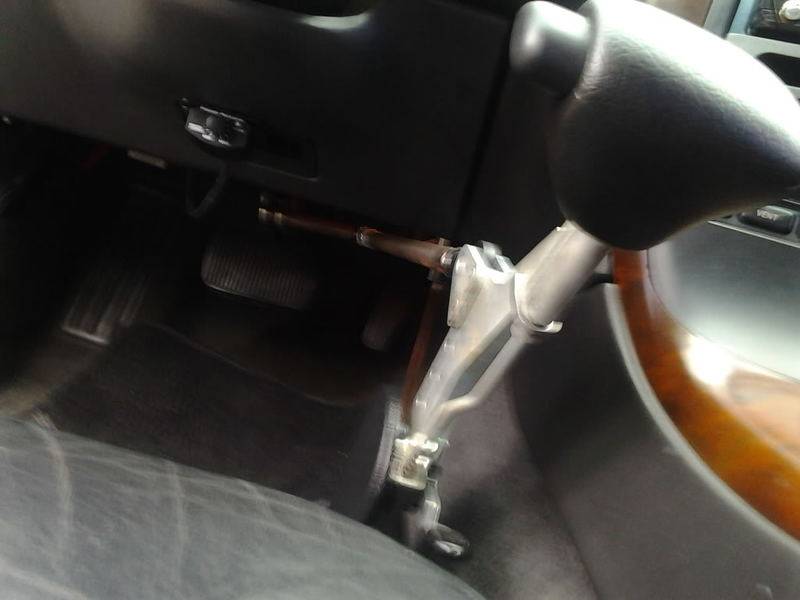

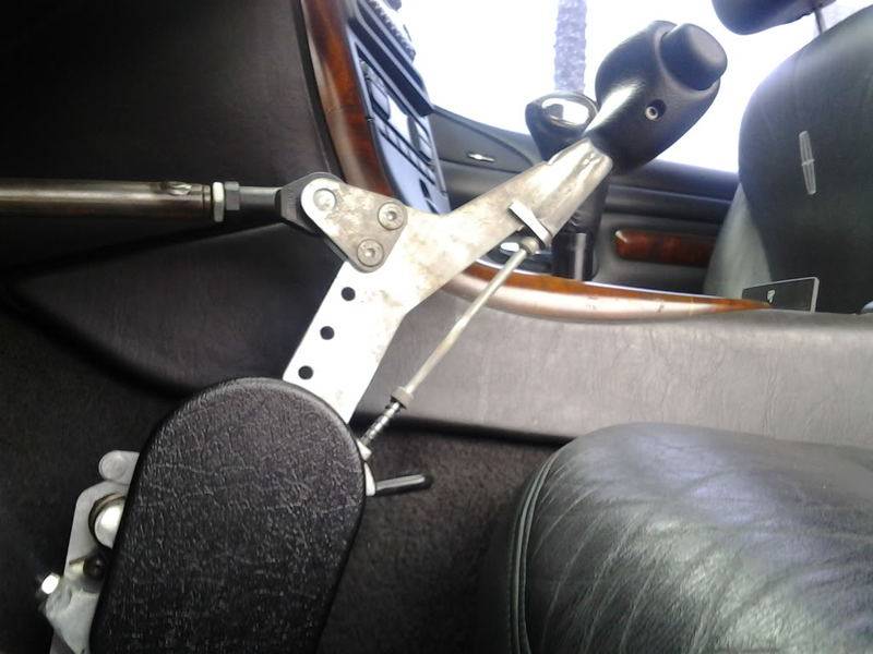

going to try run down the track. unfortunately with handicapped controls i cant hold a foot on the brake for a higher rpm launch, but from what ive seen with others driving my car and going from off idle with tc off idle seems better.:waving:
it looks and mounts about the same as a shifter handle. push foward,brake.pull back gas.i do pretty good at street lights and have brought my other cars there before the accident i was thinking of adding a line lock for the front brakes.but a friend thinks i dont need it need it i was worried about lag between holding foward on the brake to pulling back for gas but there really isnt any. he got down there and tinkered with the linkage and its spot on. anyways probobly in the next couple of weeks.ill share the ticket

I have a friend in Florida that runs a shop doing handicap conversion work. It`s pretty interesting, most of it is pretty straight forward. Some of it is custom. It`s also a serious cash cow enterprise.
If you add a Line Loc setup you will need to add two solenoids, one for each front wheel due to ABS.
