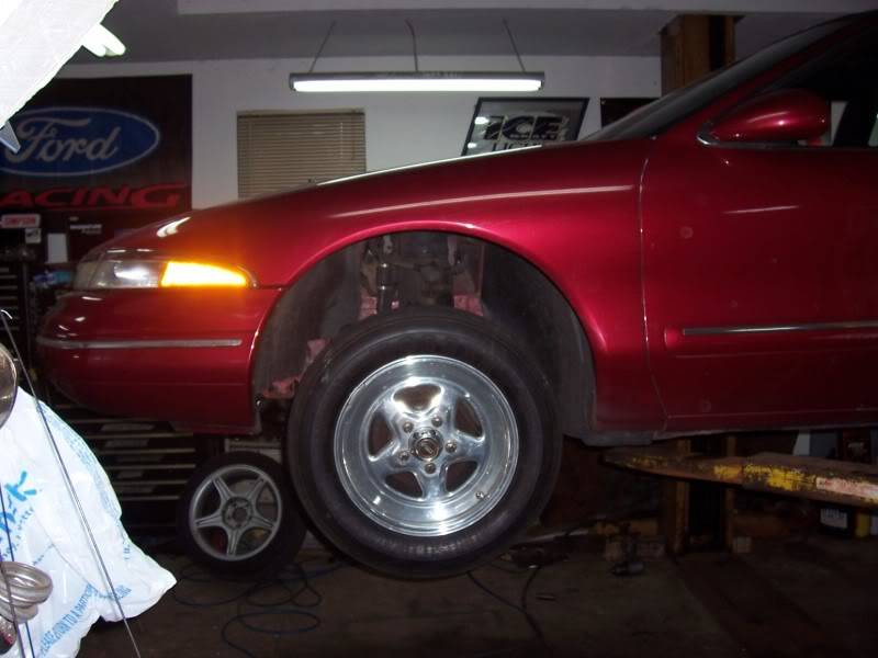

Plus they where affordable I bet. Welds are 175 each!

And they also look a thousand times better. It's not too hard to find used 4" weld wheels for cheap..go to any swap meet or check craigslist/racing junk..probably can find them with tires too.

Thanks. no one makes 4.250 BC to 4.500 BC spacers. Plus if you run thin Welds they won't clear the cobra calipers anyway so you need some sort of spacers to run the 4 inch wide rims up front.
Well you definitely have more than one thing going on there that I like. I don't have the cobra calipers either. Brake faaaaaaaaddddeee. :rolleyes:
Yep, I too have spacers with the Weld skinnies up front. PITA to swap back and forth from the street wheels.

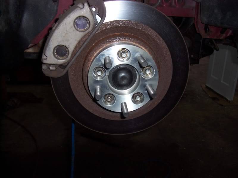

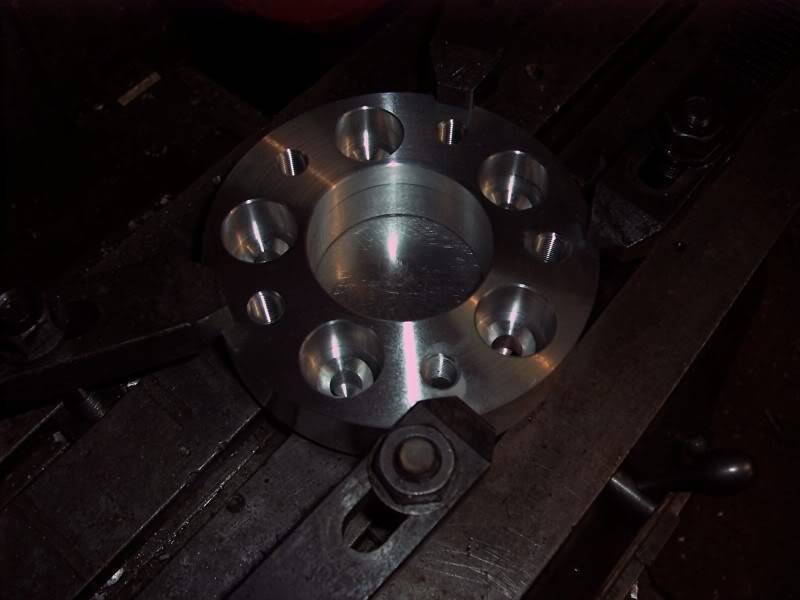

No hub swap here. I made these.
To fit Welds.

That's exactly the problem. Need to do a hub swap :rolleyes:

right on the mark, those will only work up front, right?
I would never use those adapters on a powered wheel because there is no concentric support (the center circle). The wheel is ONLY held in place by the studs which is not a big deal in the front.
Those are VERY nicely done, Right on the Mark, and they look great! I'm just saying about the center support.
The skinny fronts that I am using are only for the track. They don't really like to TURN. LOL I also ran rear spacers that looked the same but made out of steel on rear of my mustang for years and years with all different types of rims with no center support. (factory Ford SVO rims and ARE mesh rims)
I understand, I've ran non-standard rims on other vehicles I've had plenty of times where the hole in the center was bigger than stock and thus had zero support with no problems.
You and I are obviously observant enough to make sure the wheels are on tight enough and use the correct lug nuts. I work part-time at a shop and you would be surprised how many times I've seen old vehicles come in with the rim holes all reamed out because the lug nuts were a little loose or the center didn't fit. That's the only reason I pointed that out.
