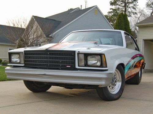

Thats two TOTALLY different things then, thats a SPOOL vs a locker. Also was the car tubbed? HUGE rear tires? If so they wear in the middle naturally anyway because of the size. Every tubbed car I ever had always wore the tires out in the middle. A locker can be used on the street any and every day all day. Again Like I stated the spool experience I have had produce 0 issues. I drove my 8.80 Bracket Malibu for the entire Summer of 2009 with a spool and 513 gears again 0 issues and that has 33 spline Strange "RACE ONLY" axels. I put over 3k HARD miles on it too. I MISS THAT CAR. malibu-10.jpgmalibu-23.jpgmalibu-24.jpg

Yes it was a FUN ride, ran the 8.90 index and was hairy as all holy hell on the street!! It was SO funny driving into Atco, running a 8.98 and driving home, I miss those days.
