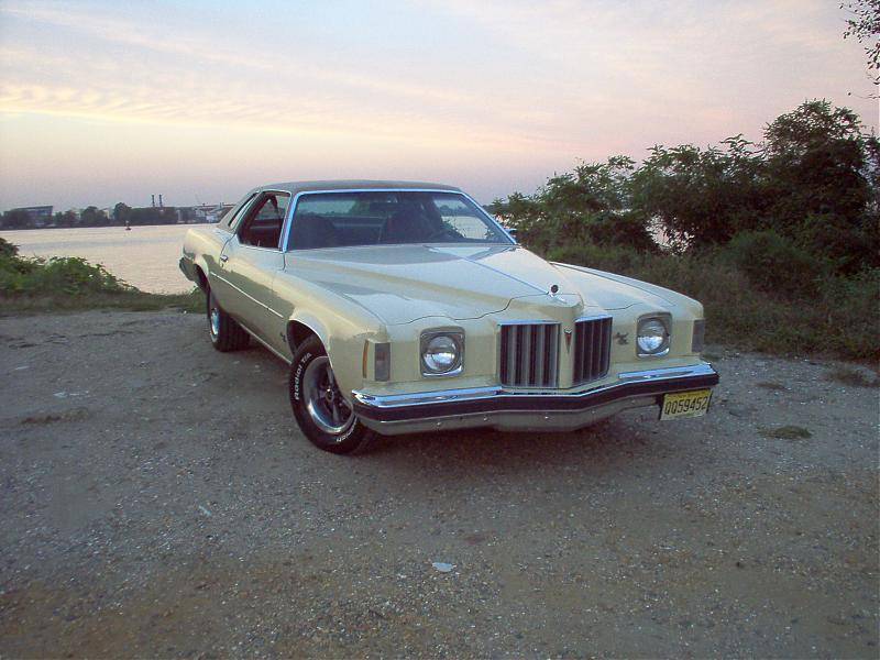

nah, for now my mark is my daily......besides i don't want to use the grand prix....which I may add I did use for 2 years everyday and NEVER had one problem!!!
