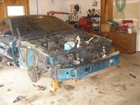

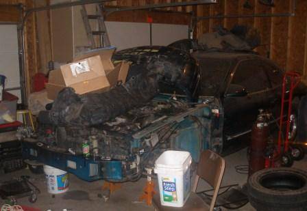

So I did a little more digging, yesterday. Luckily I didn't find anything that I didn't already expect. The entire car just needs to be gone over, I'm pulling the motor and dropping the front subframe. This will allow me to go over everything in the front end of the car. While I have the motor I plan on painting the engine compartment.
Now I just need to pick out a color, thinking about a blue.

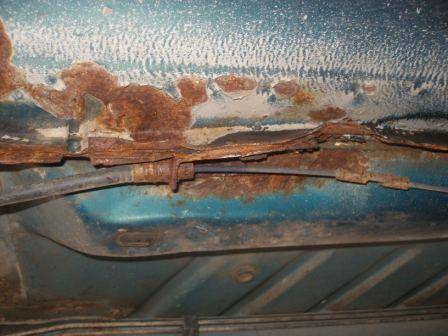

The one nasty thing I did find was the very bent peice of the unibody. My geuss is someone used a jack to lift the car from that spot and bent the crap out of it.
I did that to my car twice before i realized that it was getting bent good thing my didn't bend that bad though

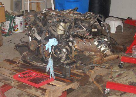

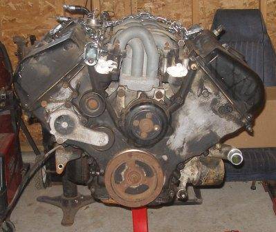

The good news is that I finally got my prioreties a little straightened out and have done some actual work on the car. I brought the "new" motor inside and am getting it prepped.

I have a few questions.
Where can I get all the torque specs for the engine fasteners? I like to actually torque things to the correct spec.
I bought a new rear crank seal but I am leary of replacing it. What is the procedure for doing this? I 'm nervous about doing this because If I screw it up I'll either have to pull the motor or drop the tranny, not good.

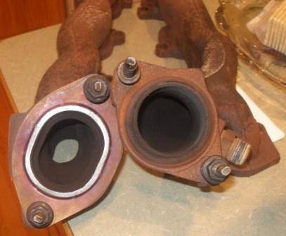

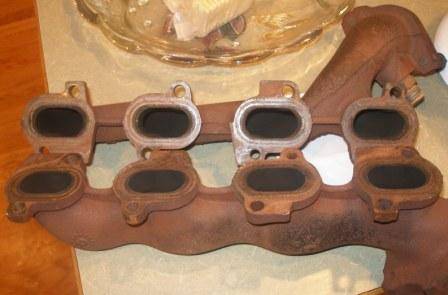

Is there any place i can purchase ends that will bolt onto the Cobra exhaust manifolds? I don't feel like fabbing the ends before building the exhaust.
I'm planning on running not cats, a double x pipe, no mufflers, and dumps before the rear tires. I know it will be LOUD, but will this have adverse affects on the motor? I heard that too free flowing exhaust can hurt the motor?

I'm disassembling the motor and cleaning/sandblasting and paitning everything before dropping it in.
screw paint!!
Powder coate!!!
Usually a haynes/chilton manual will have all your torque specs... a 4.6L building book will too (such as the sean hyland motorsports manual)
