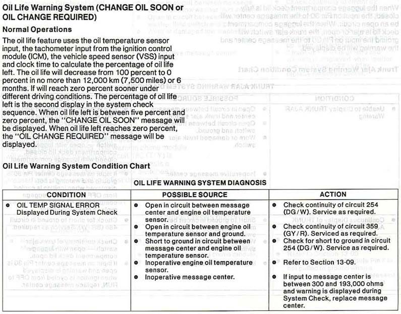

I went over to the garage and grabbed my ford manuals for ya, and this is what I found.
The oil level sensor also doubles as the temp sensor. The ECM uses this "temp" sensor to advance the oil change interval warning. I have a feeling that if you replace this sensor, you will fix your problem. This IS of course, if you have checked the plug going to the sensor, and the wiring circuit and made sure that is all OK.
There are a whole bunch of tests you can run on the sensor to check it out, and I would be willing to scan them for you to take to a local mechanic. Just let me know if you would like them.
I would run from that "dealership" that you go to as fast as you can. They obviously can't read thier own damned books. Either that or they are too lazy to work on the electronics. If I were closer to your area, I would fix it myself. Here is a quick scan, telling you about the problem.
Mike

One thing the scan said is to replace engine oil temp sensor. I had this done twice as the mechanic thought perhaps it was sticking. But after replacing twice, the same message came up.
Will check on the other things tomorrow and see what we come up with. thank you.
