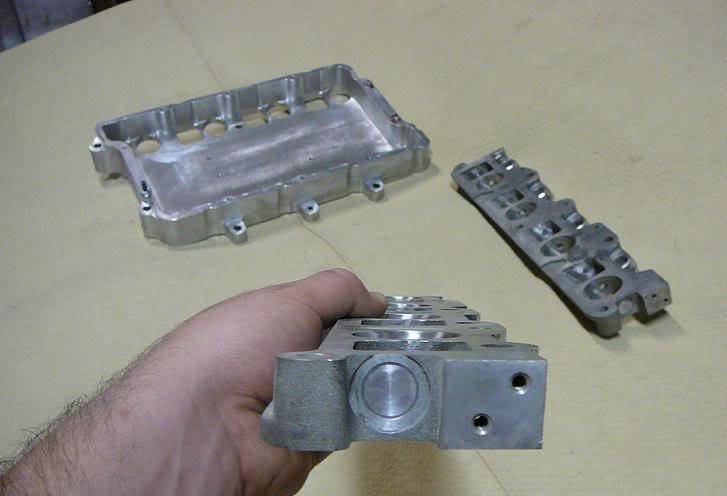

Alright I might be going to the track tomorrow to get my best time before I do the cobra intake and meth and possibly delete the imrc's, the last time I went it was only shifting at like 5900 rpm in auto so I think I'm gonna do a few runs to get my launch where I want it then I'm gonna try to manually shift it hopefully around 6800rpm my question is when would I want to shift it to get it shifting at that point and also if I do delete the imrc's can I just use apply to fill the holes in the imrc's any help would be great thanks
Don't plug the holes between runners going to the same cylinder. No matter what you use, it'll eventually fail and make its way into the cylinder. Plug the end holes and the holes between cylinders. I made aluminum plugs for the ends of my aluminum IMRC's, and I filled the holes between cylinders with JB Weld.
You dont want to plug the holes your self for risk of the plug coming out and falling in the cumbustion chamber.
The JB Weld will not escape the pockets between the runner pairs (see pic above for clarification). If you're referring to the holes between runners on the same cylinder however...:iconcur:
