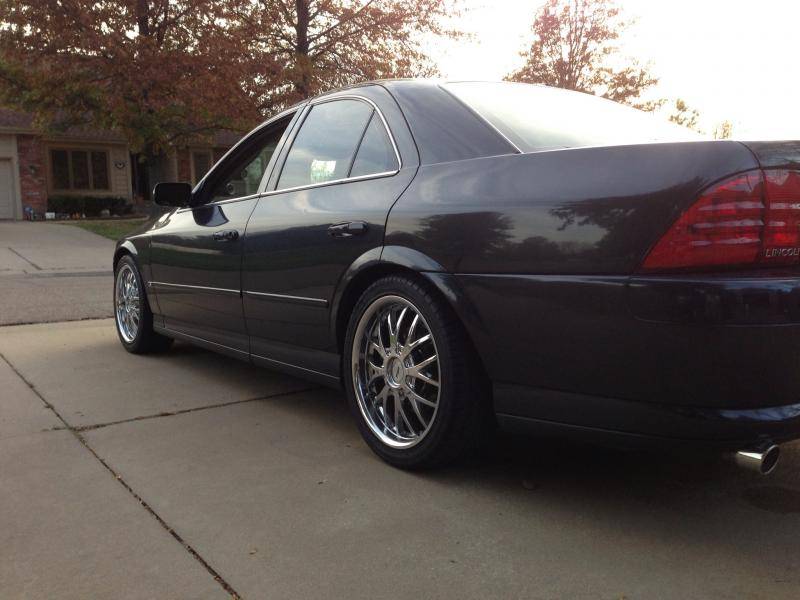

Lol you ask and you shall receive:D
I'll post more when I get to my computer. The iPad only allows one pic uploads which sucks.
I love the stance:D
it looks like they have settled a little more with driving it. Once I get the pics off of my camera i will be sure to post lots more pics.

Looks great guys, more pics and write up please !
Did you guys cut them or just out of the box like that to get that stance ?
