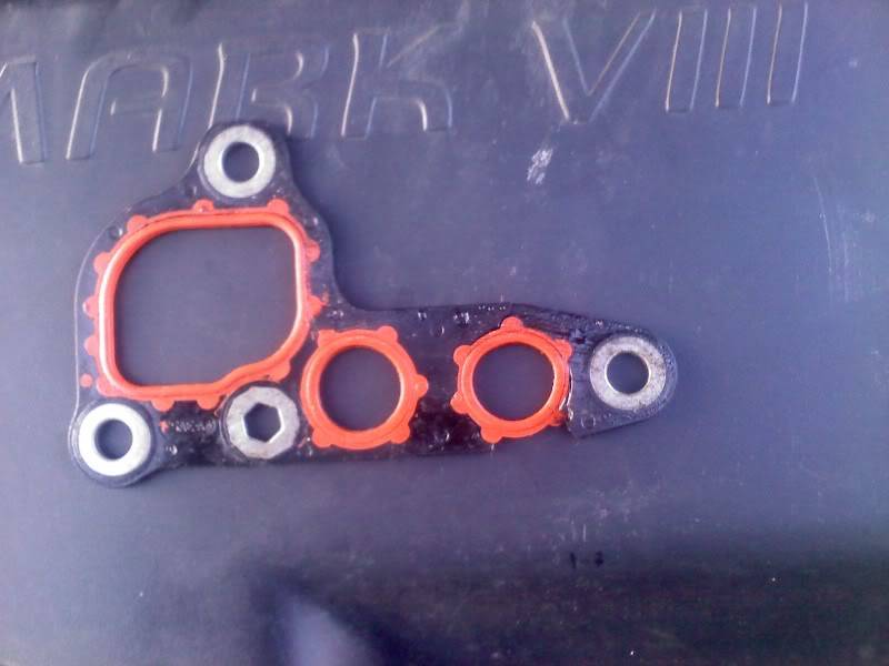

The O ring gasket let loose between my oil filter/cooler and was pouring the oil out the bottom.
I got lucky I didn't starve my engine for oil and then really have a problem :eek:
