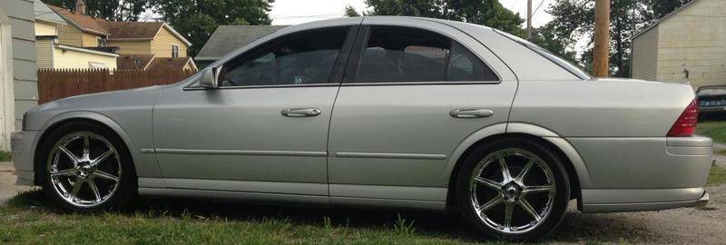

I chose to get Jaguar rims for the sake of our crazy bolt pattern..I thought about opting with spacers to accommodate another bolt pattern but I didn't want them sticking too far out..and I really don't trust the security of having spacers on. Much better to either get a Jag rim or spend the cash and get rims that fit for our bolt pattern. A PS4 is maybe $500 new..you can't get rims for that price unless you hunt for them or catch one of Malara's website discounts. I paid $300 for the Coventry Hornets on my LS..they were mounted on a Jaguar and were impeccable when I bought them..and they have a offset of +42..with the 255's that I have on the back..not trusting a spacer..but that is just luck..hope you find what you're looking for...expect to pay a little more than PS4 money.
Im actually almost bored with the Coventry's that I have on...and they are beautiful..but even if I was to sell them with the brand new tires that I just put on last week...they would have to sell way above a PS4 budget..just saying. It is an investment.
