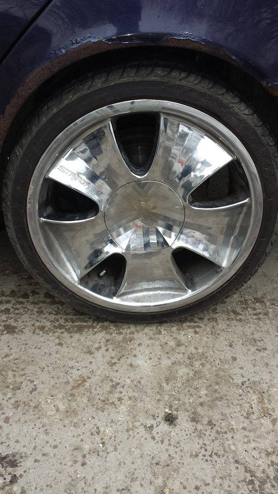

My buddy has 5x112 or something similiar
he said wheel spacers are 20$ at oreilly's?
my bolt pattern is 5x108mm correct?
what all do i need to put these babies on today?
My personal opinion - don't they are hideous. But personal opinions aside - you will need to know the off-set you will need adapters to convert the pattern from 5x112 to 5x108 which may or may not be possible depending on the off-set. I'd suggest searching the forum as this has been discussed in approx 189675 threads.
so many issues with this : 1.) bolt pattern is wrong so you need adapters not spacers 2.) you would need custom made adapters with hub centric rings to even attempt to make this work 3.) those are really ugly ( no offense man but your better keeping your stocks on and either paint those or just wait for rims that actually fit on your car directly no mods needed
alright i won't get them but, I am just looking to not have to spend monday as I have a ps4 I am trading lol
dont cheap on your car or it will cheap out on you, save up for a nice set

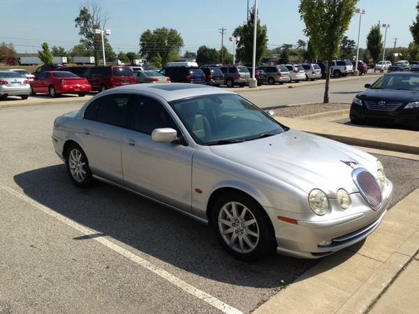

2002 S-Type Jaguar custom factory wheels (including tires) for sale
Specs: 235/50 R17 7.5x17 ET45
Tires tread is high and in great condition as these were replaced with rims then put in storage.
Car has since been sold without original wheels so I am looking to get rid of these/free up space.
Why are you hunting for wheels? For looks or is there a particular reason? If it's for looks - take your time and find what you like. Remember it's going on your car and you'll have to look at it everyday. If your wheels are cracked, bent, etc and you need to replace them asap then that's a diff story. Those Jags would fit fine but do not provide a visual upgrade per say. I loved my stock wheels and the only reason I got rid of them was because the chrome was peeling so bad it started to pierce the tires... ask Mlara - he's seen my tires :)
those would fit but if you were to stay in the 17 inch range your stocks are better looking than those ( my opinion )

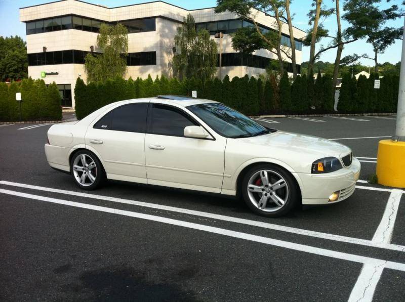

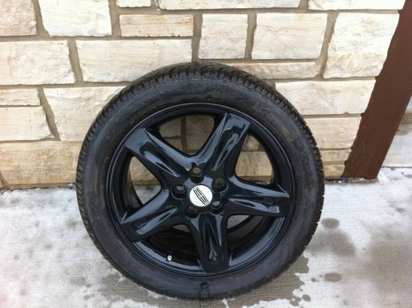

powdercoated 17s ( same rims as yours) and the second pic is 18 inch jaguar rims

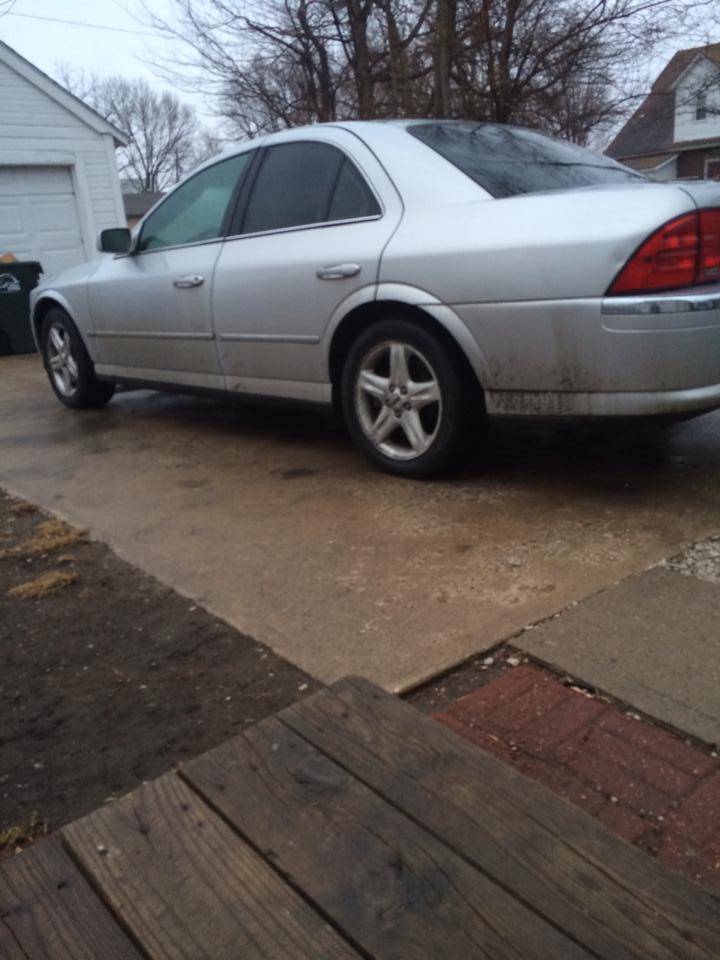

two of the stock rims are bent and it makes it hard to steer sometimes. that's why i need an upgrade lol. so do u think those would fit? and look nice?
ahhhhh well that info would have been nice to knw haha , are they bent bad ?
Ok so it's a necessity. Yes they would fit, yes its a good deal. Check the wheels by rubbing your fingers along the edges on the inside to check for bends. If you feel unsmooth areas or areas where it seems raised then there are bends and you will have the same issues you have now.
