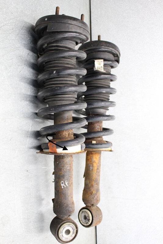

          All you have to do is order them for a Jaguar S-type and source 2 extra LS rear spring seats/isolators for the bottom of the spring and use them on the front. The rear ones are good already just order another set of used bottom seats from the rear of another Lincoln LS and use on the front and you're golden. B4 or B6 Blisten is the best way to go!
          • Agree Agree x 1

            That just the little plastic piece the spring sits on or is there more to it? I don't know the technical names for all parts, I just replace them myself if I can, LOL!
            maybe I'll try that upgrade down the road, my main goal right now is better drivability for cheaper cost cuz the whole suspension and cooling system was trashed I had to replace a lot of stuff, these KYB will last long enough for me to be able to afford the upgrade later if I want. I've already got more than double the initial cost of the car in repairs so far, and I still need new rims and tires and the stereo deck(CD player is broken but I haven't used a CD since 2008 so I'm going to replace the whole Deck with something a little more modern), current ones are rolling but they're all over 6 years old in the Chrome's peeling off my rims, ha

            It's the part I put an arrow on in the picture below.

            Okay, that's the part I was talking about. Thanks. Then you use the same spring that's already on the front and the jag shock and that's all you need?

                what's the difference between the fronts and the rears, I just changed both of mine at different times but they look the same to me already, referring to the little plastic piece underneath the spring.
                I got kybs on all four now and it rides way better than it did when I first bought it but they're all blown out, never ridden on the real ones so I don't know the difference but it's 10 times better than it was.

                The bottom metal mounting plate, on the LS), that the spring sets on... is smaller on the front shock. Same with the bottom diameter of the spring too.
                You can't put front springs on rear shocks... and you can't put rear springs on front shocks. I won't physically happen.
                The Jag S-Type uses the same diameter springs on the front and rear... and the OEM Jag shocks, ( or aftermarket Bilstein's), have the same size bottom spring mounting plate.
                The spring rates on the front of the LS are different front and rear. Same with the Jag S-Type too.

                On thanks, someone told me it was the plastic piece I needed, but you're saying it's the metal piece? I did notice the front springs are really stronger for sure, but I didn't notice the size difference but I did do them on different days so possible I just didn't notice. Thanks

                The plastic piece, (called an "isolator"), sits on top of the bottom metal plate of the shock.
                Look at the pics in this thread...

                yeah there's a arrow pointing at plastic part in the picture above, the metal part is part of the strut, doesn't appear to come off which is why I am confused about what you're talking about exactly. Thanks
